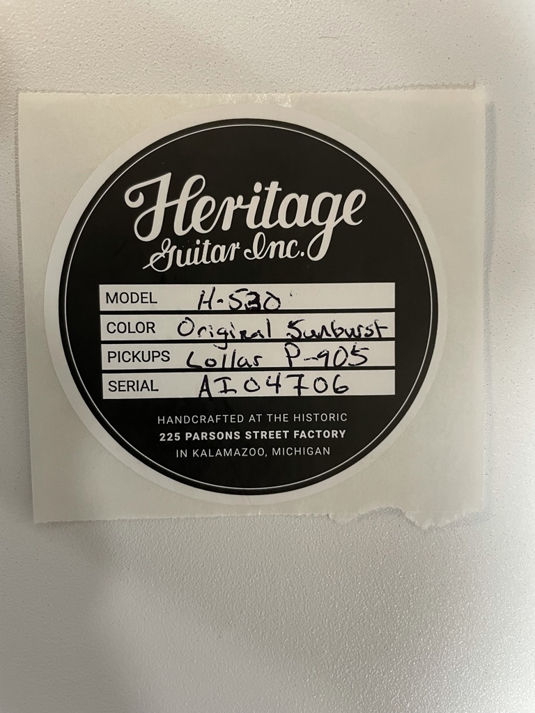

I bought an artisan aged H-530 off Reverb. What really kicked this off was an incorrect label inside the guitar.
  1. The interior label had SD Seth Lovers written on it. But this was a H-530! So I reached out to Heritage via their online contact form and almost immediately got a response. Heritage said it was QC issue and it most certainly has Lollar P90s. Their super nice rep told me he'd mail me a new, corrected label right away. I was happy!

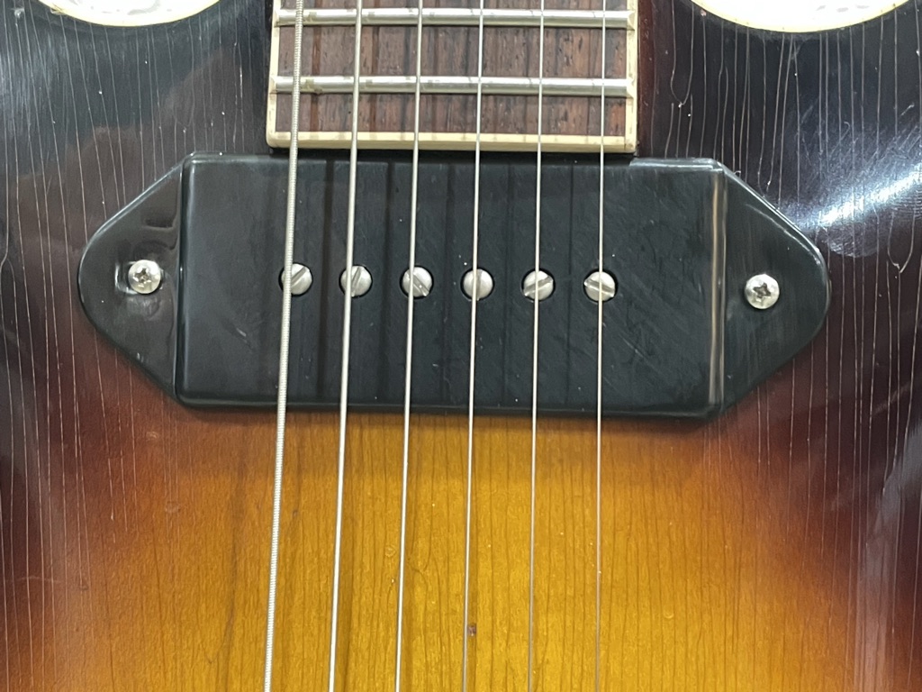

  2. Now I get to playing and immediately notice that the neck pickup cover was slightly cracked from an over-tightened screw. And one of the bridge pickup cover screws was driven at an angle. So out of four front-facing screws, two were noticeably errant.

  4. New label arrives and unfortunately it looks like my 4th grader wrote it. Not something I'd be proud to put inside my guitar, and not written by someone who takes any pride in their handwriting. Maybe I'm OCD here, but if aesthetics matter, then they matter.
I take a bunch of photos and a video, send it along to the Heritage rep. He gets right back, says he totally agrees with everything, we agree that artisan aged doesn't/shouldn't equal sloppy QC. They ask if I want to send the guitar back and get it all looked at? I say yes, please, thank you!

  2. The neck pickup cover and screws all look as they should, no errors or cracks. But there is a new, plastic shim under the cover itself that wasn't there before. I don't see it on any other Heritage that I can find. I believe it's to raise the pickup height, but I don't love how it looks. Again, easy to remove or change.
  3. The bridge pickup cover was pretty loose on one side. I was able to easily tighten one of the screws and it tightened up the cover. But I expected everything to really be pretty close to perfect considering it was being QC'd for a 2nd and 3rd time!

As far as the new label goes, my guess it was someone younger.  Penmanship isn't what it used to be, kids learn to type sooner in life making penmanship a low priority.
I received a H-530 that had a label for a H-535 with Seth Lovers. No issues at all with the guitar.
Heritage sent me a correct label and I installed it right next to the wrong label. No worries.

are the strings aligned on the fretboard, and over the pole pieces? Yours looks good in the picture provided.

The P-90 shims depended on who put the electronics on the guitar.  The slanted screw may be from the pickup originally being mounted without a shim and a shim was added at reassembly.  Adding the shim later may have required more pressure to seat the screw since that screw was originally placed deeper into the wood when there was no screw.  The cover can also crack from that.

Incorrect labels are not exclusive to Heritage.I have a 1964 ES330 which describes the guitar as ES330TDC (the C indicating
the guitar is cherry finish).Someone must have had poor eyesight,because it's sunburst !!
