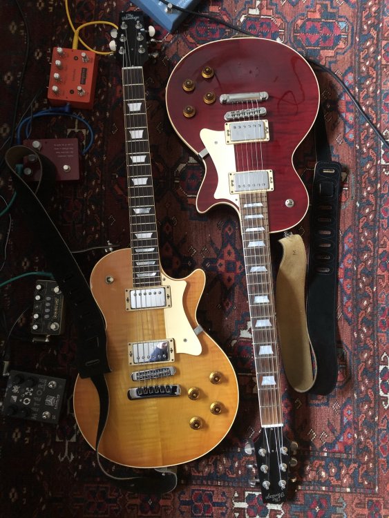

tfb Posted July 31, 2021 Posted July 31, 2021 I have two H150s: a lovely, relatively light, yellow sunburst one that I think is just beautiful to look at, and an annoyingly heavy (especially as I get older, it makes my left hand numb), annoyingly purple one which I don't want to like. But the purple one has HRWs and the yellow one has Schallers, and there is no competition, especially on the neck pickup: purple one every time. Rationally, I should swap the pickups and sell the purple one, but I don't want to get rid of either, not least because the purple one was a gift from my wife. So, assuming I don't have vast sums to spend, and assuming I really like the HRWs, what's the most HRW-like pickups I could get? Slightly lowrr output (than the HRWs)would be a mild advantage, but I obviously can deal with that. Thanks
skydog52 Posted July 31, 2021 Posted July 31, 2021 I see you are in the UK. Take a look at Bare Knuckle Mules. You might like those. Good luck with your search! Let's see those beauties. Pics?
tfb Posted July 31, 2021 Author Posted July 31, 2021 17 minutes ago, skydog52 said: Let's see those beauties. Pics? There are some already (sorry, I'd post a link but I don't know if I can find it on an iPad: look for threads by me.) PS thank you for the suggestion. These people are pretty close to me (I am at least theoretically half Cornish), so I'll talk to them!
