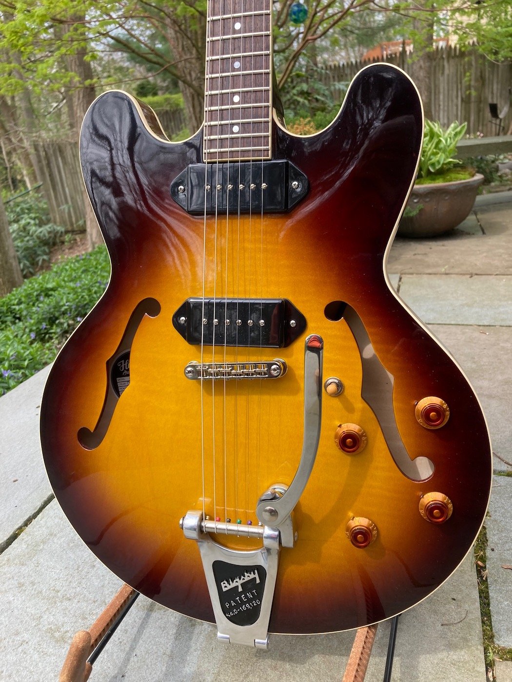

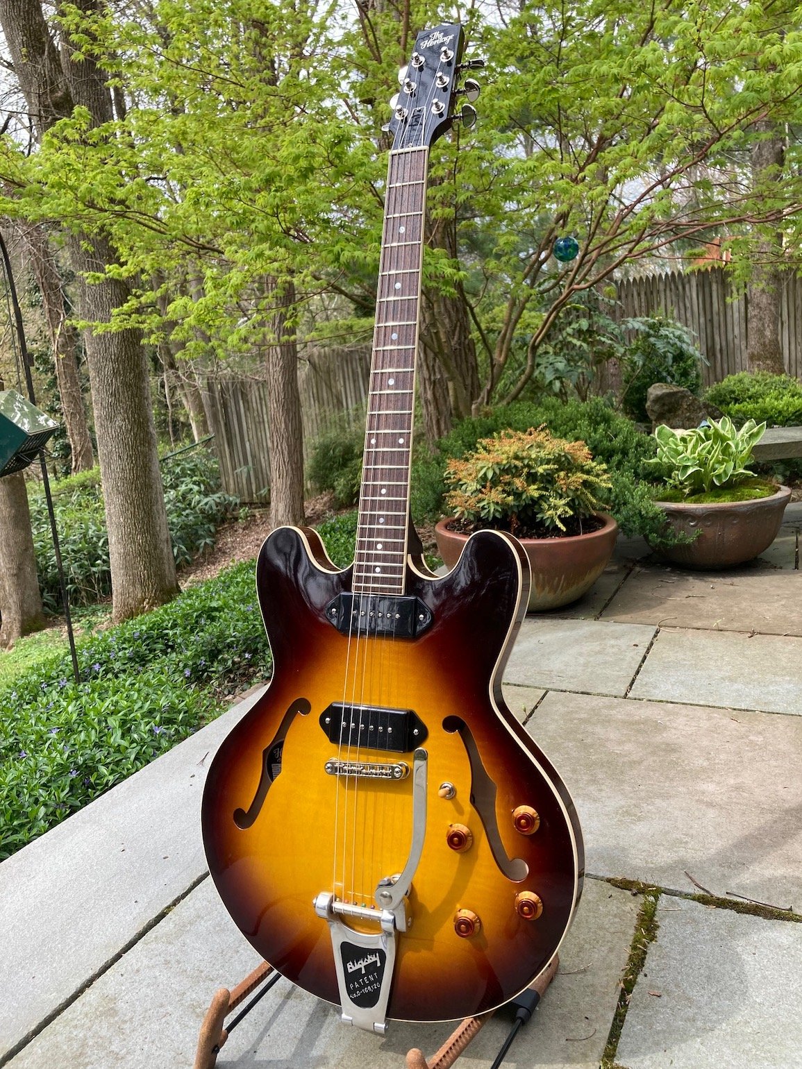

JayLo Posted April 18, 2022 Posted April 18, 2022 Hello, Heritage community. New member here with a (new to me) Heritage H-530. After decades of playing ES 330s, 335s and 345s I have finally found my gigging guitar. The H-530 is light, has the long neck and killer pickups. The workmanship is excellent, and the price (used) was just unbeatable. As with all of my guitars, I just can't let a good thing alone: I added a Bigsby (for my playing style), and replaced the knobs and the switch tip (for looks). In order to tame the brightness of the pickups I'd like to switch out the metal saddles on the bridge for nylon saddles. But I can't get out the screws. Has anyone done this? Or would I need to replace the entire bridge? If so, which one? Any help would be greatly appreciated. Thank you so much. J

JayLo Posted April 22, 2022 Author Posted April 22, 2022 Congrats on your H-530. I installed a Bigsby B3 like this https://reverb.com/item/45502370-new-bigsby-b3-vibrato-kit After taking off the trapeze tailpiece I discovered that two of the holes line up with the B3 and I needed to drill only two small holes. Make sure that you get the B3 for thinking semi acoustics guitars, NOT the B3 for large arch tops. The latter has a different hinge which is pointed and longer. Good luck with the installation.
JayLo Posted April 22, 2022 Author Posted April 22, 2022 Oops: Should be thin semi acoustics. BTW, the Bigsby springs are quite stiff. I prefer the softer type and installed one from Reverend Guitars ($10)

JayLo Posted June 25, 2022 Author Posted June 25, 2022 Update: Replaced the original bridge with a Tonepros NVR2G - N with the nylon saddles. A direct replacement incl. the posts. Works like a charm. I did this to tame the harshness of the pickups but also to make it easier on the strings because of the Bigsby.
