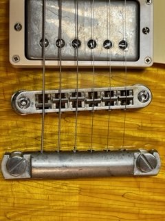

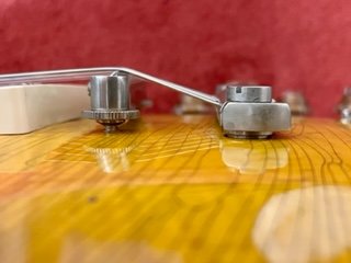

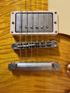

bobmeyrick Posted April 29, 2022 Author Posted April 29, 2022 Forgot to mention that because the Faber ABR is narrower than the Nashville, the tailpiece can be lowered right down without the strings touching the bridge.
Kuz Posted April 29, 2022 Posted April 29, 2022 4 hours ago, bobmeyrick said: Forgot to mention that because the Faber ABR is narrower than the Nashville, the tailpiece can be lowered right down without the strings touching the bridge. Amen!!! Faber is the way to go, forget the Tone Pro stuff. With Faber hardware no more losing or stripping those tiny allen screws like Tone Pros uses. On 4/27/2022 at 7:21 PM, ElChoad said: I just recently found out that TonePros makes a locking aluminum tailpiece. I may have to investigate a little and add a locking tailpiece to my Custom Core. Get the Faber locking Tailpiece posts and use the Aluminium Stoptail that came with your Custom Core. That's what I did.
Kuz Posted April 29, 2022 Posted April 29, 2022 Like I said, I used Faber Hardware on my Artisian Custom Core, both the locking ABR-1 Bridge and the locking Stoptail posts. The first picture is the original Core hardware (where I couldn't lower the tailpiece that WAY above the body because the strings were hitting the Nashville bridge). The second & third pictures are with the Faber Hardware (HUGE improvement in my opinion).
