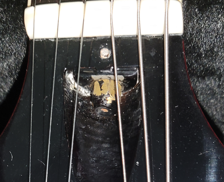

musicalfish Posted July 14, 2022 Author Posted July 14, 2022 For context, here's a picture of the truss rod nut. It doesn't have any threads coming out of either end of the nut, and the part towards the top of the headstock has maybe a millimeter of space before the rod would be flush with the nut.

DetroitBlues Posted July 26, 2022 Posted July 26, 2022 Looking at the truss rod nut, usually its "maxed" out when the thread of the truss rods are sticking out from the nut. This is just the opposite. The strings force the neck to bow upwards and the truss rod pulls it back down. Seeing that picture, it doesn't seem like the strings are bowing the neck much at all. But I agree, talk to Heritage about it. from their website: support@heritageguitars.com(269) 247-5405
pressure Posted July 26, 2022 Posted July 26, 2022 My experience has been different from yours DB. The strings pull the neck into a backwards curve creating a dip (high relief), then tightening the truss rod pulls the neck up, straightening it.
DetroitBlues Posted July 26, 2022 Posted July 26, 2022 1 hour ago, pressure said: My experience has been different from yours DB. The strings pull the neck into a backwards curve creating a dip (high relief), then tightening the truss rod pulls the neck up, straightening it. Maybe I said it backwards?
rockabilly69 Posted July 30, 2022 Posted July 30, 2022 On 7/26/2022 at 9:50 AM, pressure said: My experience has been different from yours DB. The strings pull the neck into a backwards curve creating a dip (high relief), then tightening the truss rod pulls the neck up, straightening it. this is how a truss-rod works, DB definitely has it worded backwards.
