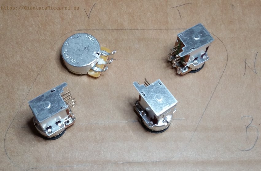

Gianluca Posted August 17, 2022 Posted August 17, 2022 Hi All ? Came back to this after some time. I posted about it some time ago but looks like my content about my H150 Gold Top is not available anymore or I wasn't able to find it. Recap: On my H150GT, the previous owner installed Bareknuckles The Mule set (the original HRWs are in the case). The Bareknuckles have four wires: black, white, green, red and bare. I wrote to the PU makers and asked if I could rewire the pots and PUs so to have split coils on each PU and out of phase B/N, all using push-push POTs. They kindly replied with two practical schematics graphs available at the following links: Coils Split Out of Phase So I bought three push-push POTs and a regular one. I plan to keep the original CAPs (if they are original). When I was younger I used to build my pedals, but that's long gone, I know how to solder but I never went more than wiring my jack cables. What I'd like to achieve is a split coil and a OOP configuration. I am not sure though how to combine the two schematics the staff at BK emailed me. Looking at them I should go with: OOP on the Bridge Volume split coils on both Tone Volumes I think the previous owner didn't do the best job ever, you can see the switch cable being almost burned, and the soldering looks a bit rough IMO. All suggestions are greatly welcome, or maybe better a schematics to share, I think if I give myself a predefined workflow it's better. Some questions at this stage: the non-push/push POT I have it's a 550k when the ones installed are 500K but I think that should be fine? are there any better wiring solutions that could give a more interesting tone, like for example series/parallel? buying another push-push POT for the Neck Volume, could I achieve some extra layout to switch in to? thank you All PS I made myself the cardbaord template

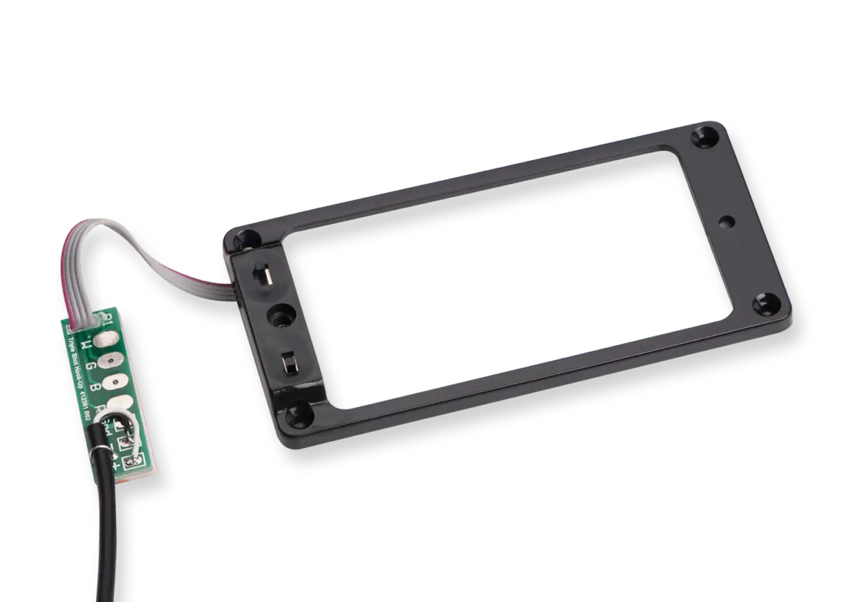

Gianluca Posted August 19, 2022 Author Posted August 19, 2022 SD says they sell the connector with their Triple Shot Mounting Rings found another number of solutions too

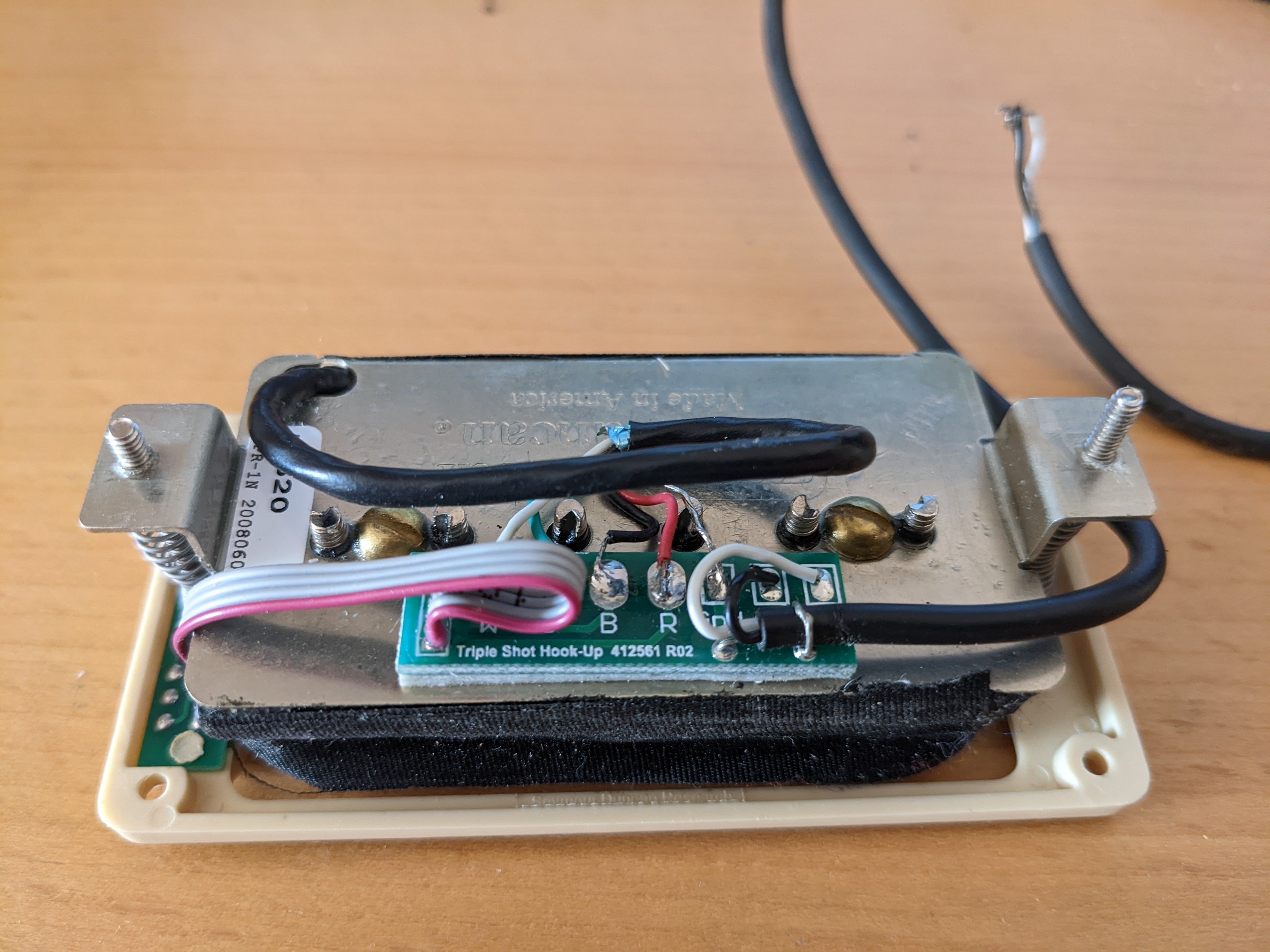

bobmeyrick Posted August 20, 2022 Posted August 20, 2022 I don't think the connector is sold separately - it's an integral part of the Triple Shot connecting to the switches on the ring. I've used the Triple Shot rings with P-Rails. The idea there is that the wires from the pickup are soldered to the terminals on the pcb, which is then stuck to the underside of the pickup. With space in the pickup cavity being very limited, I found it necessary to shorten the cable from the pickup quite considerably. However, the Triple Shots are ideally suited to P-Rails, and much more convenient than using push-pull pots. You have the options of coils in series (full humbucker) P90 coil rail coil coils in parallel Triple Shots can be used with other humbuckers, in which case P90 coil becomes the outer coil, rail coil becomes the inner coil.
Gianluca Posted August 20, 2022 Author Posted August 20, 2022 33 minutes ago, bobmeyrick said: I don't think the connector is sold separately indeed it's only sold as the inline picture above there are a number of solutions, but I think to use a JST for the jack plug and screw terminal connectors for "plugging" the PUs and the selector cables, only consideration that comes to mind is if the signal is better preserved with a soldering connection (maybe it is) From Seymour Douncan's diagrams I see they use .047 CAPs but I'll leave the .022 I have

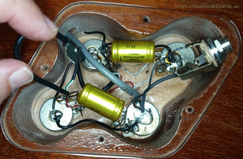

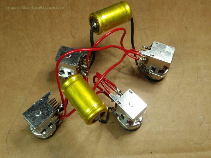

Gianluca Posted August 24, 2022 Author Posted August 24, 2022 received the other Alpha DPDT POT, un-wired the H150 recovered the CAPs and tubed the terminals (not shrinked) I'm following the wiring shown on this video: https://www.youtube.com/watch?v=PS7YvCmop8Y the Alpha are good because they're small enough but I think a possible better solution for such a wiring are something like this: maybe allowing for less contortionism ? that's how my prewiring is looking like as of now, need some more wires though I know, my soldering-fu is weak but it's been a long time I think gounding the circuit will be last thing I'm not comfortable with the idea of driving the solder iron through the wires in the controls cavity, I'll try to do the last solderings before mounting the POTs back in place ? ...it should be possible
Gianluca Posted August 26, 2022 Author Posted August 26, 2022 ok, so a first installation test results in: - the Neck Vol switch mutes everything when engaged - a "ground" noise kicks in when rolling halfway any of the two N/B Vol POTs - general Volume lowered the rest is working and it's very interesting I need to make a better template, something that could be used on the sides too so like a box, use better wires for wiring the POTs like thinner wires I used a terminal connector that helped "plugging" the new wiring in place and I think the idea is not bad (and adopted buy others too clearly) and to get better at soldering ?
kbp810 Posted August 26, 2022 Posted August 26, 2022 Double check that all your ground connections are good; and that you're hooked up to the bridge ground wire. I like using hi-temp pvc jacketed wire; comes in handy working in tight spots. Don't have to be quite as deliberate with the soldering iron as to not risk torching the insulation off a wire. Example: https://www.tubedepot.com/products/20-ga-high-temperature-pvc-wire
Gianluca Posted August 26, 2022 Author Posted August 26, 2022 thought the same abou the ground, I think the terminal connector I used is not ideal, but definitely ground needs to be better understood and wired thanks for that link, very useful, I'll check that
