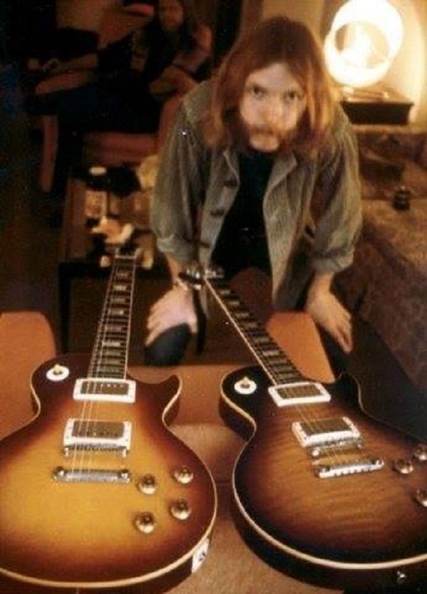

This guy did also.

So Duane playing a lot of slide guitar wouldn't have the strings popping off the saddles, and Billy G used heavier strings (before BB King set him straight) and probably liked the slinkier feel of top wrapping.
