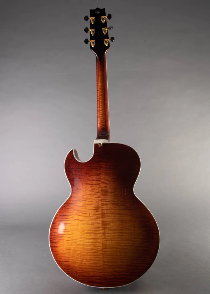

These are some of the photos from Carter Vintage where I bought it.

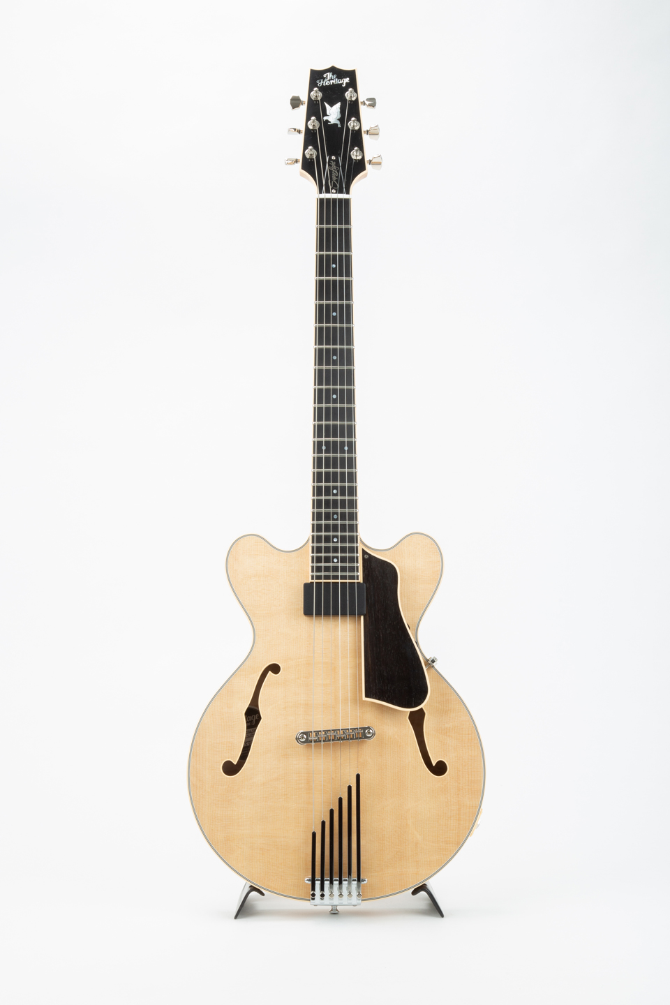

This is what they used on the last final builds.

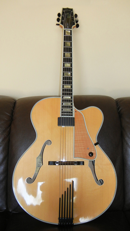

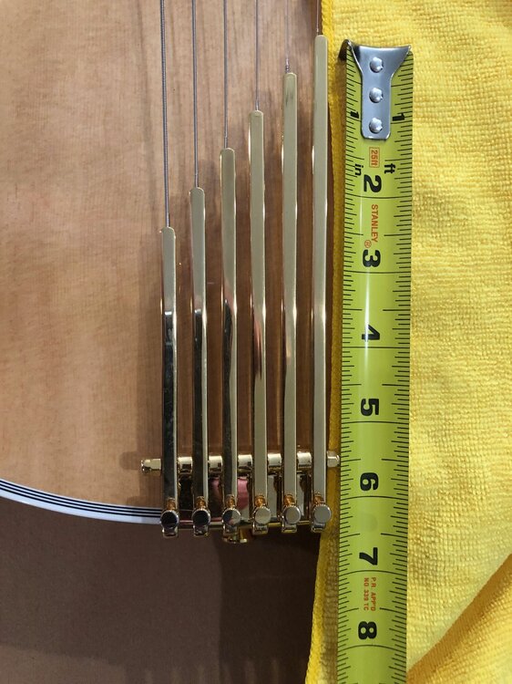

Here you go.
A Heritage Johnny Smith, which is similar to your Heritage Sweet Sixteen, has a distance of approximately 9 3/8" from the end of the guitar to the bridge. The length of the finger tailpiece on a Heritage Johnny Smith is 6 31/8" on the treble side and 4" on the bass side.
I have put finger tailpieces on Heritage Millenniums and they use the smaller tailpiece which has a distance of approximately 7 7/8" from the end of the guitar to the bridge. The length of the the shorter finger tailpiece is 5 1/2" on the treble side and 3" on the bass side.
ABM are great to deal with. Hope this helps.
