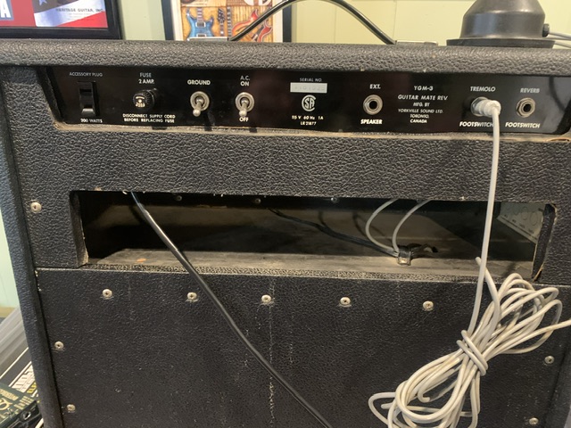

DetroitBlues Posted June 27, 2023 Author Posted June 27, 2023 On 6/27/2023 at 9:35 PM, Steiner said: THIS! ^^^ What a great idea! No ground loops, no worrying about pedal settings, etc, etc... Bravo Gitfiddler! Expand The Traynor doesn’t have an extension output…

Steiner Posted June 28, 2023 Posted June 28, 2023 On 6/27/2023 at 11:58 PM, DetroitBlues said: The Traynor doesn’t have an extension output… Expand Dean Zink.

DetroitBlues Posted June 28, 2023 Author Posted June 28, 2023 On 6/28/2023 at 2:06 AM, Steiner said: Dean Zink. Expand Ah, checked again. It does… think it’s 8ohm…
Steiner Posted June 28, 2023 Posted June 28, 2023 On 6/28/2023 at 3:31 PM, DetroitBlues said: Ah, checked again. It does… think it’s 8ohm… Expand It "should" be the same as the installed speaker. Remember, the two outputs are wired in parallel. A quick web search should reveal the impedance.

DetroitBlues Posted June 28, 2023 Author Posted June 28, 2023 On 6/28/2023 at 3:41 PM, Steiner said: It "should" be the same as the installed speaker. Remember, the two outputs are wired in parallel. A quick web search should reveal the impedance. Expand I've been searching... Still searching...
kbp810 Posted June 28, 2023 Posted June 28, 2023 Looks like it is indeed 8ohm, in parallel with internal speaker
kbp810 Posted June 28, 2023 Posted June 28, 2023 Of course to confirm; could always check the impedance of the current internal speaker and see if it falls within the would of what is considered to be 8ohm (likely will ready around 5-7 ohms).
DetroitBlues Posted June 28, 2023 Author Posted June 28, 2023 I could easily do that. Unfortunately, I only have a Celestion Creamback Neo in 16ohm, so I'll need to find something else.
DetroitBlues Posted June 28, 2023 Author Posted June 28, 2023 On 6/28/2023 at 5:06 PM, Steiner said: Two 16ohm speakers in parallel is an 8ohm load. Expand A 2x12 16ohm cabinet in parallel will work?
Steiner Posted June 28, 2023 Posted June 28, 2023 On 6/28/2023 at 7:13 PM, DetroitBlues said: A 2x12 16ohm cabinet in parallel will work? Expand Yes, IF you put another 16ohm speaker in your amp cab. Perhaps something akin to a Celestion Creamback Neo in 16ohm...
