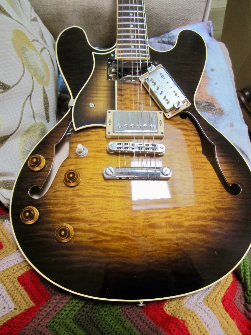

nitroman58 Posted July 1, 2023 Posted July 1, 2023 I have a 2001 model year Prospect blues. I thought the former owner told me that these came stock with the Seymour Duncan Seth Lovers, but I am not sure. I do like the bridge pickup, but I have found the neck pickup to be muddy for my tastes. Is there a pickup, or pickup set that would work well in this model? Thanks
bolero Posted July 1, 2023 Posted July 1, 2023 Well if they are Seth Lovers I'm surprised the neck is muddy? Have you popped the pups to verify what they are? Lowering the neck pup away from the strings can help clear it up, fwiw
nitroman58 Posted July 1, 2023 Author Posted July 1, 2023 I am going to pull them out to see for certain.
skydog52 Posted July 1, 2023 Posted July 1, 2023 Is that a Ed Roman Blues Prospect? We love pictures here. ?
nitroman58 Posted July 1, 2023 Author Posted July 1, 2023 1 hour ago, skydog52 said: Is that a Ed Roman Blues Prospect? We love pictures here. ? Yes. The tag on the inside reads "Ed Roman Blues Deluxe OSB". This seems strange since the guitar does not have the features of the deluxe. I will add pictures shortly. BTW, its a lefty.

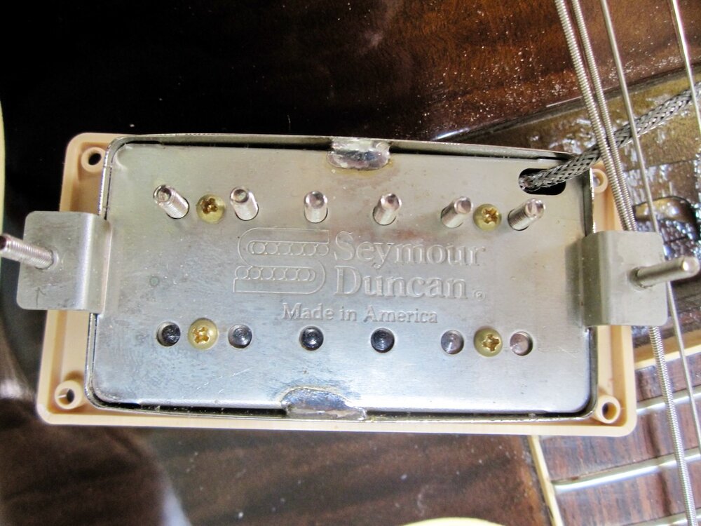

nitroman58 Posted July 1, 2023 Author Posted July 1, 2023 They are Seymour Duncan's. I would assume the Seth Lover's since that is what the former owner said, but I cannot say with certainty. Would Heritage be able to tell me?
bolero Posted July 3, 2023 Posted July 3, 2023 I'm not familiar enough with SD to be able to tell without a label & product number. The Seths I've seen have the signature inked on the bottom. Ed Roman had some unique SD pickups made that he used in his guitars, didn't he? Maybe reach out to Seymour Duncan? They may know how to ID
nitroman58 Posted July 3, 2023 Author Posted July 3, 2023 Thanks. I will do that. 3 minutes ago, bolero said: I'm not familiar enough with SD to be able to tell without a label & product number. The Seths I've seen have the signature inked on the bottom. Ed Roman had some unique SD pickups made that he used in his guitars, didn't he? Maybe reach out to Seymour Duncan? They may know how to ID
bolero Posted July 3, 2023 Posted July 3, 2023 Just had a thought: maybe the label fell off the pickup & is still inside the gtr? Also did you check the bridge pup? And good luck!
nitroman58 Posted July 3, 2023 Author Posted July 3, 2023 28 minutes ago, bolero said: Just had a thought: maybe the label fell off the pickup & is still inside the gtr? Also did you check the bridge pup? And good luck! That is possible since I did have the wiring reversed for left handed orientation.
nitroman58 Posted July 5, 2023 Author Posted July 5, 2023 I contacted Seymour Duncan today, and they were very helpful. The bridge pickup did have the Seth Lover mark, and the signature. I send pictures of both pickups, with the reading in ohms. The rep said based on the pictures and readings that they are not wax potted so they are both Seth Lovers.
