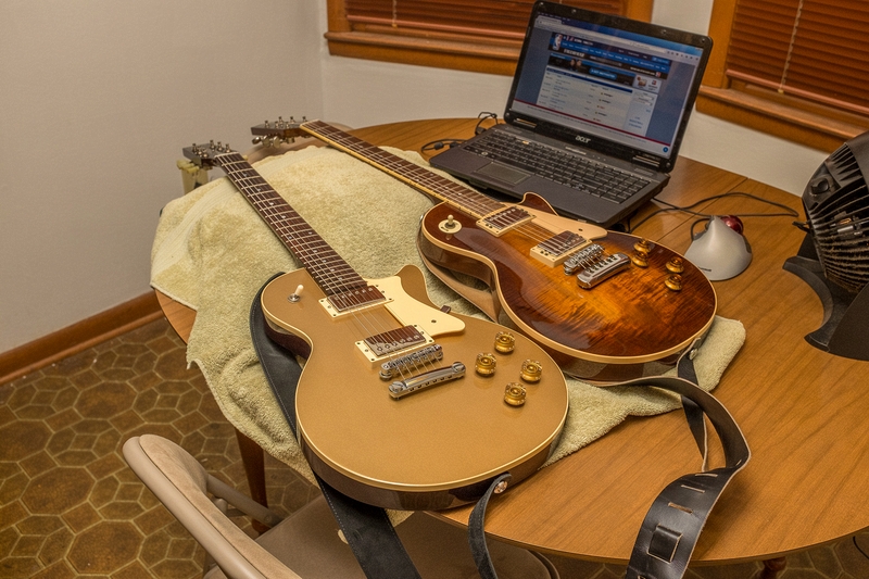

High Flying Bird Posted July 10, 2023 Posted July 10, 2023 19 hours ago, bobmeyrick said: The other 150 which had dots on the fingerboard was the Special. I have one and its body is a bit thinner (1 5/8") and the fingerboard is bound. Here is a photo of my buddy's 150 Special. It has the bound fingerboard. The guitar next to it is my gold top 137 custom.
