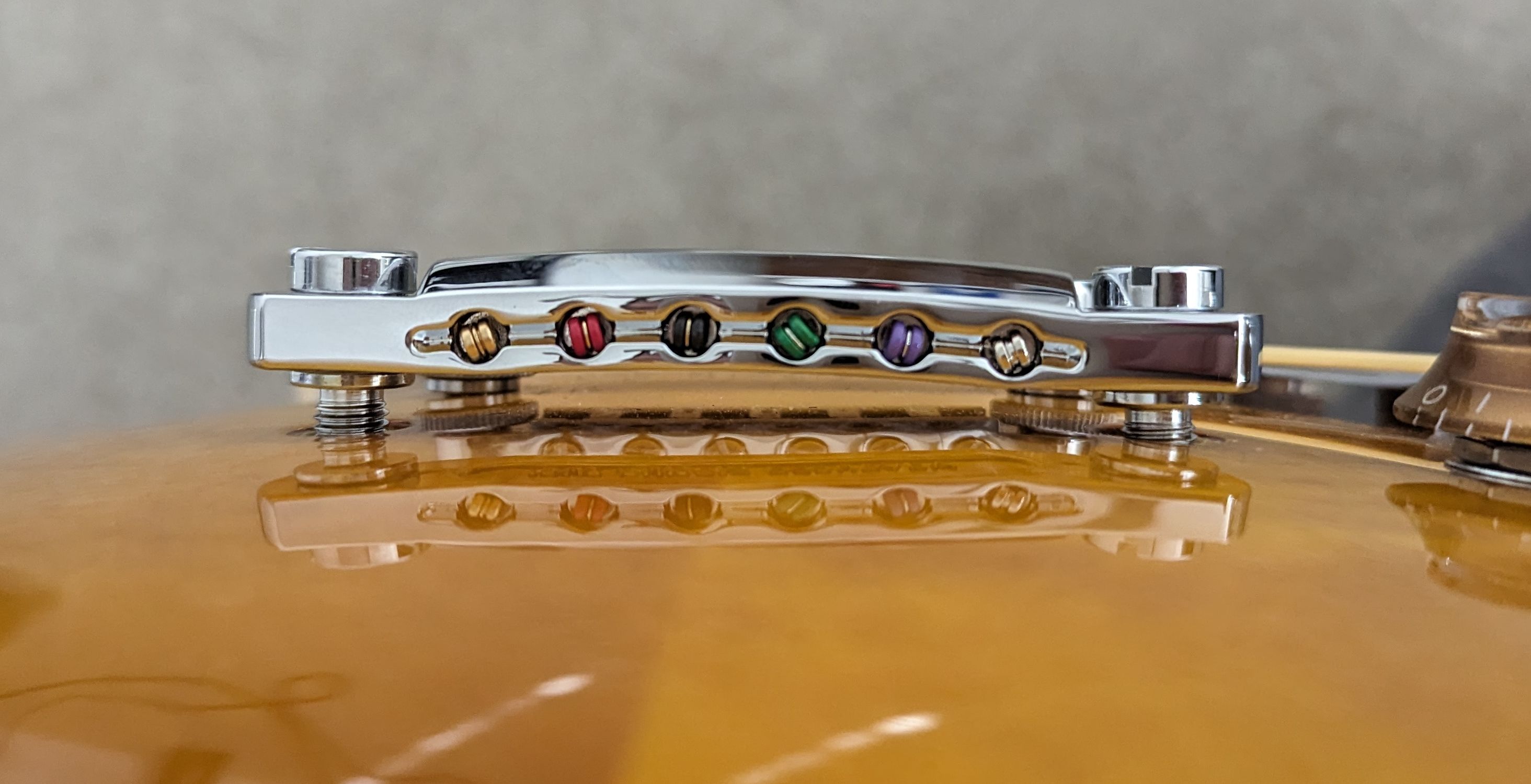

Spectrum13 Posted July 14, 2023 Posted July 14, 2023 16 minutes ago, Kuz said: It states on Faber's website "For Heritage Guitars" and lists the parts. Yes did not think I had to say more but appreciated affirmation.
kbp810 Posted July 14, 2023 Posted July 14, 2023 Ahh, well my apologies for the pedantic posts and unnecessary tag in then. Spectrum, fyi - from my view your original post just appears as a dead image link.

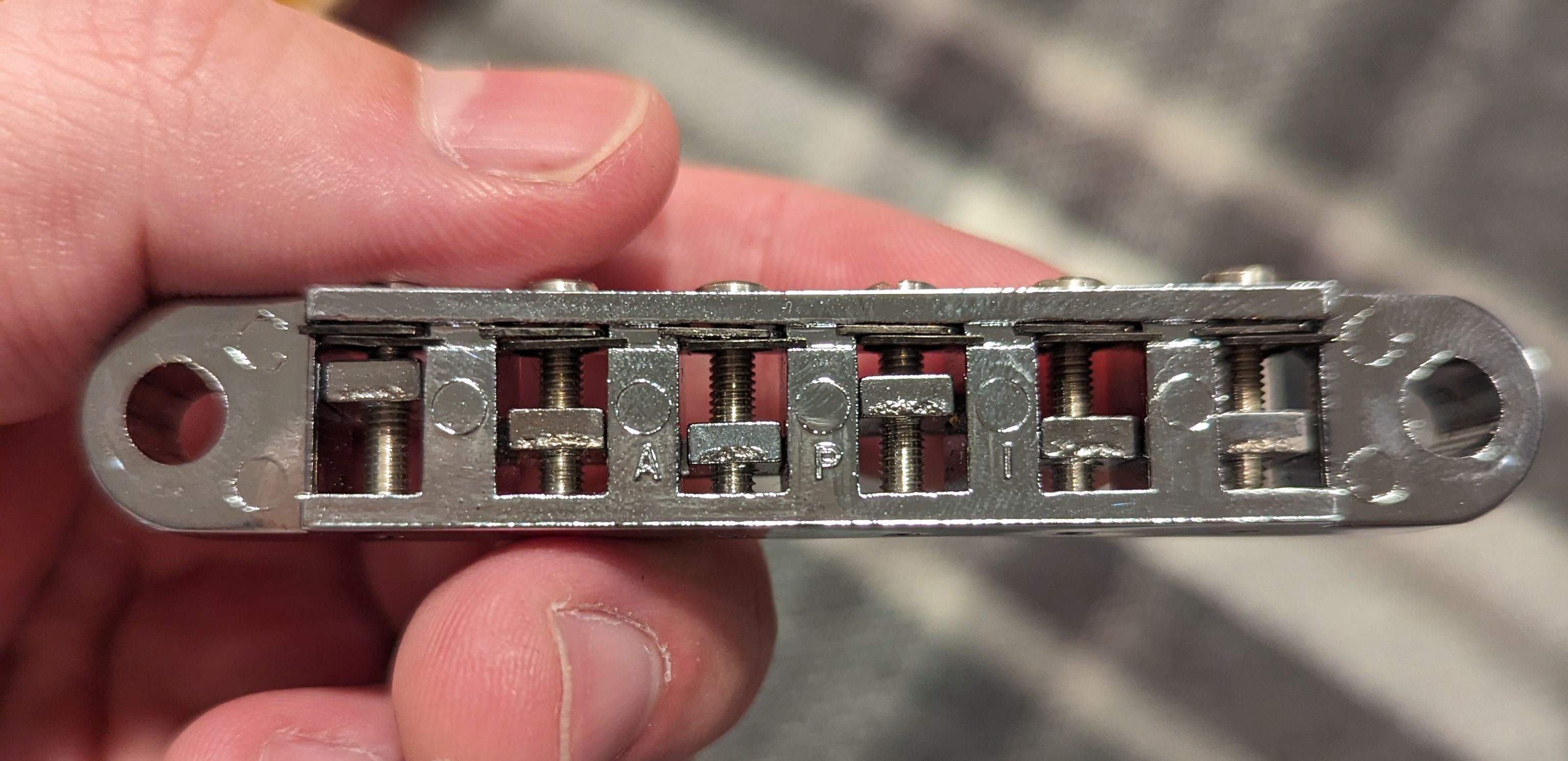

musicalfish Posted July 16, 2023 Author Posted July 16, 2023 Thanks! I actually took the bridge off, and took a picture of the bottom. The tailpiece seemed to be stuck and I couldn't get it off. Not sure if there is some locking mechanism I'm not seeing. The bridge has "API" written on the bottom. I'm guessing that is Advanced Plating Inc? Doesn't seem to be the Schaller bridge like Faber is assuming comes on the Heritage. Here's a picture:
hopkinwfg Posted July 16, 2023 Posted July 16, 2023 7 hours ago, musicalfish said: Thanks! I actually took the bridge off, and took a picture of the bottom. The tailpiece seemed to be stuck and I couldn't get it off. Not sure if there is some locking mechanism I'm not seeing. The bridge has "API" written on the bottom. I'm guessing that is Advanced Plating Inc? Doesn't seem to be the Schaller bridge like Faber is assuming comes on the Heritage. Here's a picture: I suppose its a nashville bridge clone ... but are the measurement exact am not sure... Have contacted the guys at Faber and what he describe on measurements if i recall correct is correct... Heritage changed from using Grover tuners and nashville bridge to their own supplier clone... thats what the folks here says ....

musicalfish Posted July 16, 2023 Author Posted July 16, 2023 Interesting. Mine definitely has Grover tuners. That bridge and tailpiece don't look like mine either. My bridge posts are solid at the top, and my tailpiece doesn't have the holes for set screws.
hopkinwfg Posted July 16, 2023 Posted July 16, 2023 Mine is a H150 in oxblood i bought a couple of months ago... Not really a good experience i had with Heritage honestly due to the poor hardwares installation it got... The non grover tuners it came has a rather rough touch not as smooth as the original grover tuners.. The bridge stud is slanted so gotta fix it and was lucky enough to be able to take out the tailpiece well ... and will be getting in the faber bridge and tailpiece and the grover tuners ?
musicalfish Posted July 16, 2023 Author Posted July 16, 2023 I actually checked my tailpiece posts and they seem to be slanted as well. The bridge looks like it may be too. I've had this guitar over a year now and haven't noticed! Since the posts may be slanted, maybe it's better to let sleeping dogs lie and not mess around with replacing something that seems to be working fine. The slant won't cause any issues, right? I'm able to intonate just fine and I get a low action, so no playability issues. Mostly concerned about longevity or issues coming up down the road. But I haven't had the best experience either, this is actually a replacement for another one that had its truss rod maxed out after a few months.
