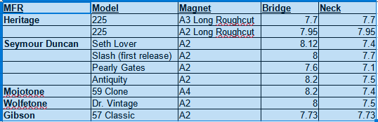

I did some testing and analysis. For the 225 pickups, I swapped the magnets to Alnico 2. Unexpectedly, it increased the output from 7.7k to 7.95k. Then I got the meter out for some other pickups to do some comparisons. Take a look at the chart below.
I like the bridge pickup with Alnico 2. The neck pickup is still too bassy sounding.  I'm going to try putting Alnico 5 in the neck to see if that evens things out a bit. But that's a test for tomorrow.
Hey that's interesting, thx for posting.
Funny the 57 classic & 225's are the only pups with Neck & Bridge @equal readings
I'm testing magnets in them. So, yes. If I decide to resell them, I will put the original A3 magnets in them.

Yeah, it’s normal for the resistance ratings to change with magnet swaps. Has something to do with magnetic strength.
While resistance will change when a magnetic field is introduced, I'm surprised that it would make that much differences, since A2 and A3 are very similar in strength, with the A3 actually being slightly weaker than A2.    Based on that, adding an A5 should make a big difference, since A5 is even stronger than A2.
