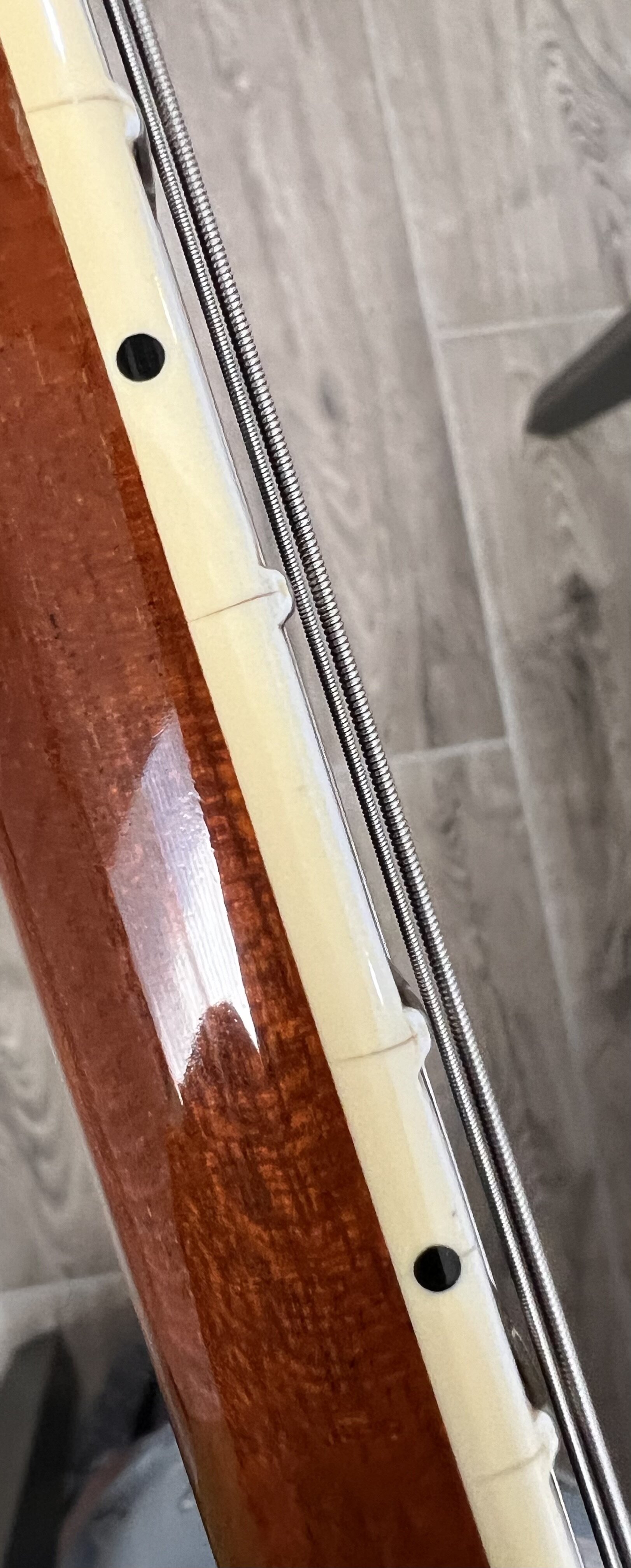

Genosinger Posted December 25, 2023 Posted December 25, 2023 Any idea why this happened to my 2000 Milli?
MartyGrass Posted December 25, 2023 Posted December 25, 2023 That's very common. With temperature and humidity changes, metal responds differently than wood. The fret marker area must have cracked due to weakening on the binding there and wood moisture changes. Some guitar companies don't bind over the frets. It's more work. I don't even notice the binding cracks on the neck because they seem inevitable. https://www.mylespaul.com/threads/cracks-in-binding.467486/ https://forum.gibson.com/topic/77373-slight-cracks-in-fretboard-binding/ https://www.everythingsg.com/threads/is-cracked-binding-normal.19180/
dvnmjc Posted December 25, 2023 Posted December 25, 2023 It is minor on the fingerboard binding. Nothing really to worry about or do anything for. Totally normal, especially with a nitrocellulose finish.
TalismanRich Posted December 25, 2023 Posted December 25, 2023 MG is right on the money. If there was no binding, the guitar would probably be exhibiting some fret sprout which happens with the wood dries out and shrinks. That's one of the big advantages of having that binding over the edge. You'll never rip open your hand sliding up the fretboard!
yoslate Posted December 26, 2023 Posted December 26, 2023 21 hours ago, davesultra said: Totally normal, especially with a nitrocellulose finish. 18 hours ago, TalismanRich said: MG is right on the money. If there was no binding, the guitar would probably be exhibiting some fret sprout which happens with the wood dries out and shrinks. On 12/25/2023 at 12:12 PM, MartyGrass said: That's very common. With temperature and humidity changes, metal responds differently than wood. All of the above, of course. And if you'll notice, the crack is right where the tang is for each fret. That would make perfect sense regarding both Marty's and Rich's observations.
Jackman Posted January 5, 2024 Posted January 5, 2024 I have two H535’s, both are from 1997 and both were purchased new (by me!). My ASB has been played less, and is in better overall shape but has the exact same neck binding cracks at each fret. You can’t feel it when playing and have to look close but they are there. My amber version has been played more but has no cracks. Both guitars were stored in my humidity controlled room and stored in their cases when not played. It’s just something that happens and I’m sure my other guitar will eventually develop them over time. I wouldn’t hesitate to buy a guitar with those micro cracks. As long as binding isn’t separating and the cracks aren’t noticeable when playing. I’ve seen acoustic guitars have binding separate from the body, that’s a different matter.
