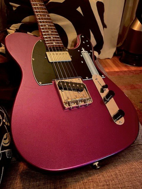

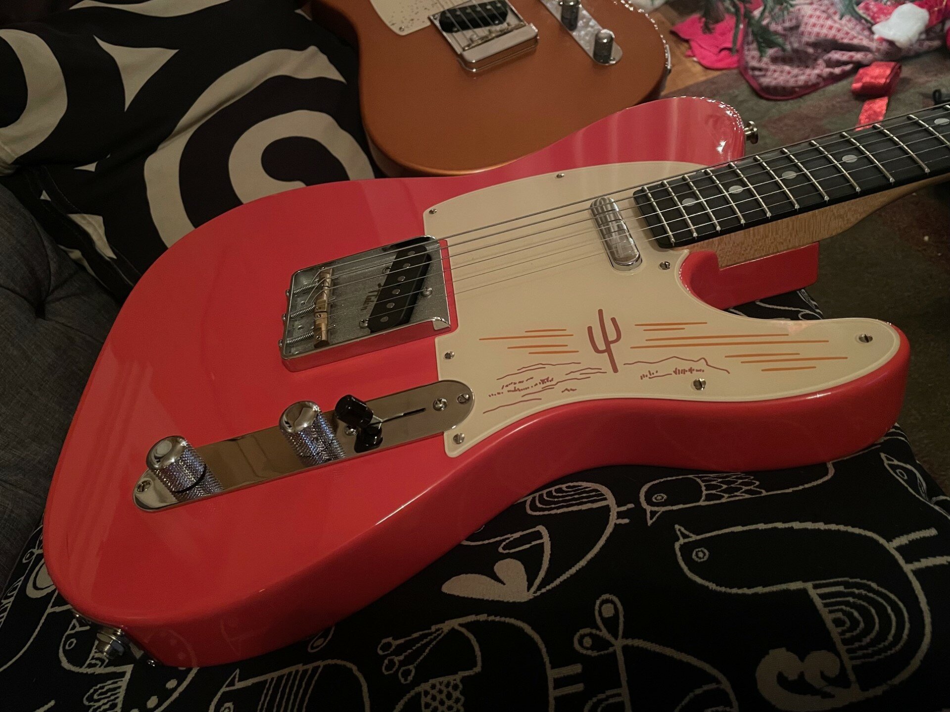

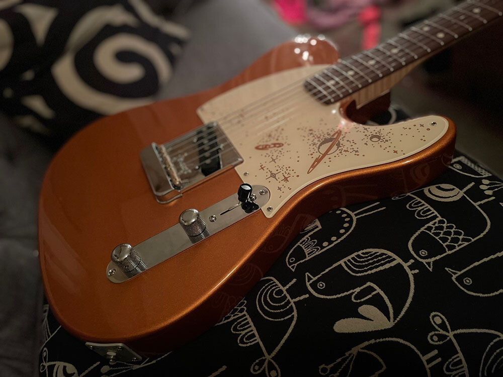

Rich,  I built or rebuilt (swapped necks and pickups etc) 7. I currently have 5 Teles that I built, 2 Fiesta Red Teles, Gold Esquire, Brown Tele Deluxe and Purple Tele with humbucker and single coil. I also built an Esquire with a British racing green body, but I tore that one apart, because I wanted the pickup for a different build, and the neck for another one, I gave the green body to a friend. I also have a reverse headstock Tele that a friend gave me and custom shop that I've had for a long time. The reason I'm doing this is because I've always like the idea of Telecasters, but never really bonded with one as a full time guitar. Now though, through my experimentation, the gold Esquire and purple Telecaster have turned out to be monster guitars that I could use as full-time giggers. Two things that I've learned is that I like hot bridge pickups, and 9.5 radius fingerboards with slightly bigger frets, The other Teles are all fine guitars since I've tweaked them but the gold and purple have the magic...

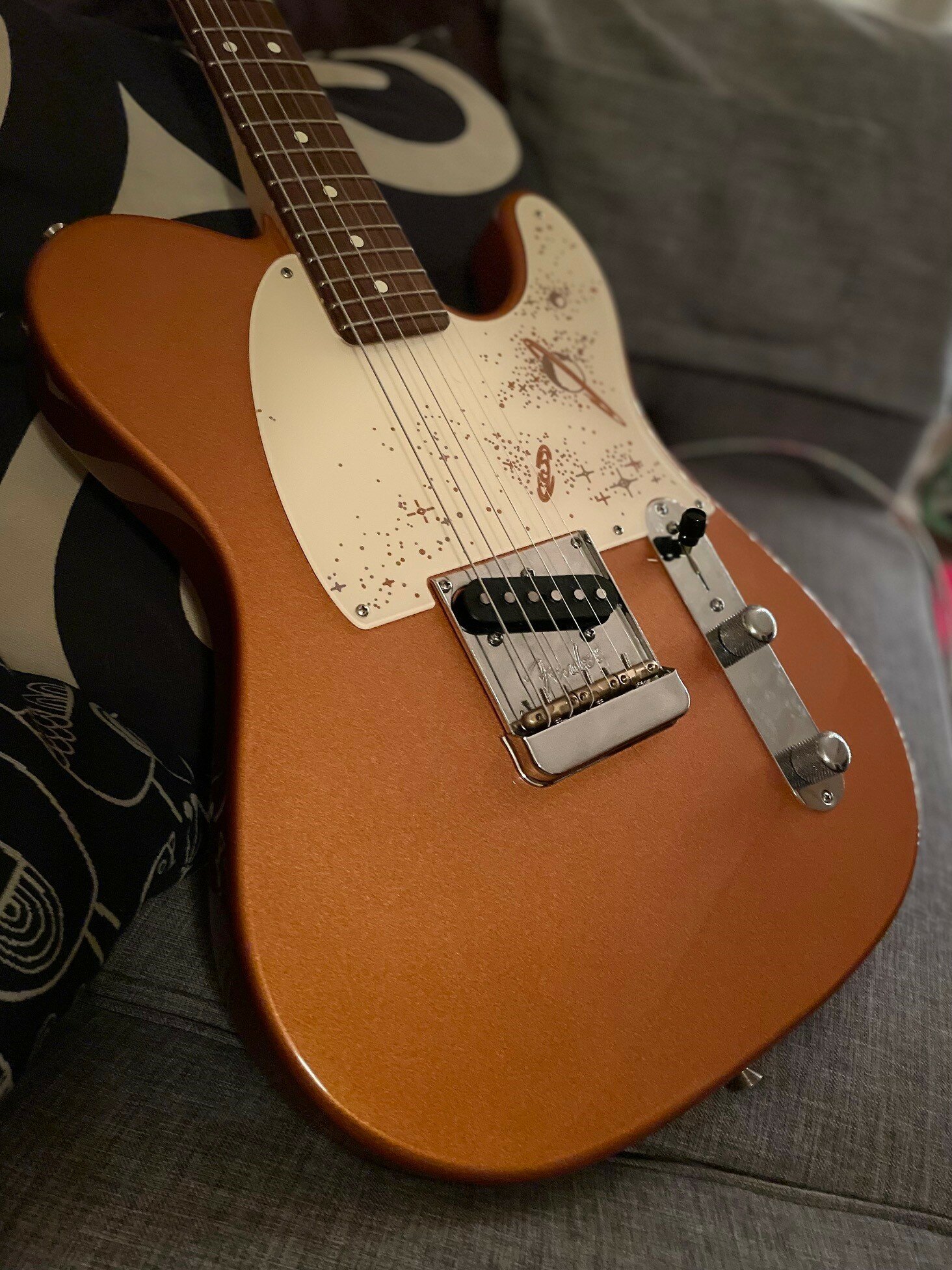

This one has American Professional neck with Rosewood fingerboard (9.5 radius), and Fender locking tuners, Guitarfetish Poplar Body, Decoboom pickguard, American Professional bridge, Nocaster Holy Grail Pickup, Eldred Mod wiring

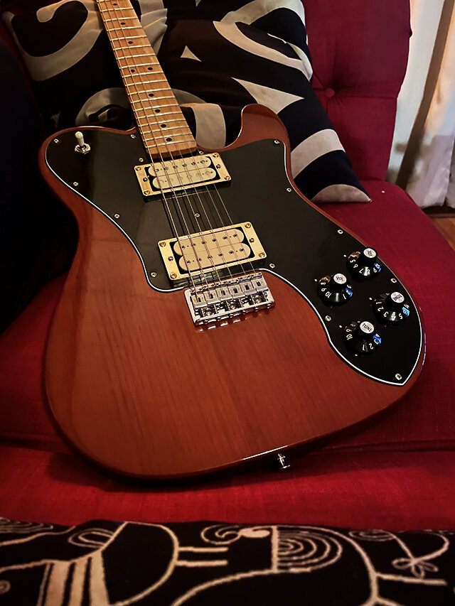

This one has Allen Eden Paulownia body, Decoboom pickguard, Ebay seller from China Flame maple neck with rosewood fingerboard (9.5 to 12 compound radius) Fender 52 reissue bridge, Tyson Precious and Grace neck pickup, Billy Gibbons BG1400 bridge pickup,

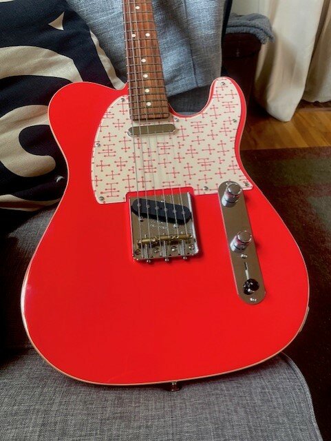

Guitarfetish Fiesta Red Poplar body, Decoboom pickguard, Fender Roasted Maple neck with Pao Ferro Fingerboard (9.5 radius), DiMarzio Twang King pickups, 4 way reverse switch with series wiring on the 4th position.
Fiesta Red Warmorth Poplar Body, Decoboom Pickguard, Wolftone Cub and B*tch pickups, Fender Limited Edition painted headstock flame Maple neck with Ebony fingerboard and locking Fender tuners (9.5 radius), Halon bridge.
