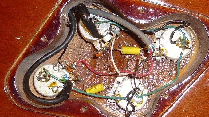

Depending on how you like to roll off volume,  I added a treble bleed to my 157 for a while.   I liked it's effect more than 50s wiring or standard wiring.
Here's my 157 control cavity with treble bleeds and the stock pots and caps.   As I had changed a noisy switch,  I changed the cable running up to the switch with a shielded cable. (the grey stuff).
Thanks for the reply. I've used treble bleeds in the past on Les Paul's with good success, I may need to think about that on this one. I like the taper on the pots they used work just fine. This guitar was in the case for most of it's life so the pots were scratchy and the 3-way was nearly stuck in place. Contact cleaner resolve those issues. The guitar it's self has a smoky smell to it. Any idea how to address that? The case is easy I've had it in the sun for the last two weeks and the smell is all but gone. I appreciate. it.
