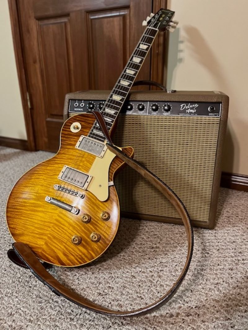

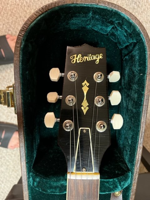

Kuz Posted April 28, 2024 Posted April 28, 2024 On 4/27/2024 at 5:51 AM, rockabilly69 said: The only thing I don't like with the new guard is the relic-ing, especially on the tuners and around the headstock. Another thing, on the custom cores, I think they should offer unpotted humbuckers, for what they are chargior CCs, I think they should cut a deal with Throbak! They should also use better bridges (Faber or ABM would be nice), and better tuners, like Japanese made Klusons (or upscale Gotohs). But all all in all, I think Heritage has upped their game. 1) I like the feel and generally the look of the "aging" on CCs. But the headstock aging is a little too much for sure. 2) The tuners do suck. I replaced them with drop in Gotohs and it is a HUGE improvement. 3) The pickups sound OK, but I like A2s so I dropped in a used set of Throbak SLE-101s. I called Heritage to see if they would sell me a set of unpotted Parson Street pickups, but they said no because they were all currently potted.
hopkinwfg Posted April 29, 2024 Author Posted April 29, 2024 On 4/28/2024 at 11:48 PM, Kuz said: 1) I like the feel and generally the look of the "aging" on CCs. But the headstock aging is a little too much for sure. 2) The tuners do suck. I replaced them with drop in Gotohs and it is a HUGE improvement. 3) The pickups sound OK, but I like A2s so I dropped in a used set of Throbak SLE-101s. I called Heritage to see if they would sell me a set of unpotted Parson Street pickups, but they said no because they were all currently potted. Cool !! Show us ya H150CC? Yup i agree the tuner sucks.... it happened so with the new H150 too its not the regular grover instead its a 3rd party replica.... But which gotoh tuner model you went with? As for the potted PU... you might wanna take out the covers and do alittle heating over ya PU hopefully most of its wax would melt out ? I haven tried the 225 parsons H150CC pickups yet... but so far am pretty happy with my R9 R8 both had burstbuckers and its really open and aggressive sounding ! For potted A2 PU not sure how well it holds out...
davesultra Posted April 30, 2024 Posted April 30, 2024 Fortunately the tuning machines on my CC150 are holding up just fine. However, I really do wish they would have used something different. My only gripe with Gotoh is that they don’t make their tuners in nickel.
Kuz Posted April 30, 2024 Posted April 30, 2024 2 hours ago, davesultra said: Fortunately the tuning machines on my CC150 are holding up just fine. However, I really do wish they would have used something different. My only gripe with Gotoh is that they don’t make their tuners in nickel. Awe, but they do.... I ordered some 510s off ebay with a new "Antique Nickel" finish. I will report back when they come in, installed, and post pictures.
Kuz Posted April 30, 2024 Posted April 30, 2024 11 hours ago, hopkinwfg said: Cool !! Show us ya H150CC? Yup i agree the tuner sucks.... it happened so with the new H150 too its not the regular grover instead its a 3rd party replica.... But which gotoh tuner model you went with? As for the potted PU... you might wanna take out the covers and do alittle heating over ya PU hopefully most of its wax would melt out ? I haven tried the 225 parsons H150CC pickups yet... but so far am pretty happy with my R9 R8 both had burstbuckers and its really open and aggressive sounding ! For potted A2 PU not sure how well it holds out...
