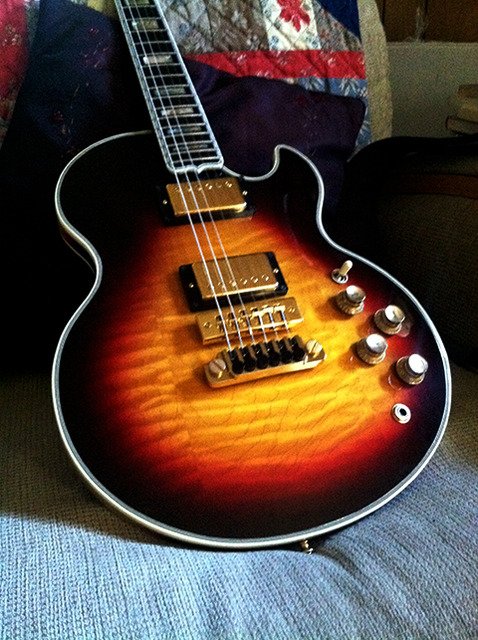

rockabilly69 Posted April 25, 2024 Posted April 25, 2024 Wipe the entire guitar down with naptha. I've done this to a few smokey guitars. and it has helped immensely. Naptha is safe for nitro finishes! I'm personally not a fan of the ozone generator or fabreeze. I tried that many times and either didn't work (ozone genrator) or my guitar smelled like Fabreeze, which I find almost as unbearable as smoke! Leaving my case out in the sun did help immensely help. but I had to leave it outside in my backyard every day for almost a month before it took hold. The little fan trick sounds like it would work for hollow body! And I also thought that was the charcoal sounded like a good idea! Good luck!

rockabilly69 Posted April 27, 2024 Posted April 27, 2024 On 4/25/2024 at 7:57 PM, LonelyLefty said: When you used the naptha did you dilute it or did you use it straight? Was it VM&P naptha? Thanks so much for the reply. I use plain Zippo lighter fluid, non-diluted, and it works great! My guitar not only smelled of smoke, but of of dank basement. And now it smells fine (like old nitro)! This is the guitar I'm referring to...
