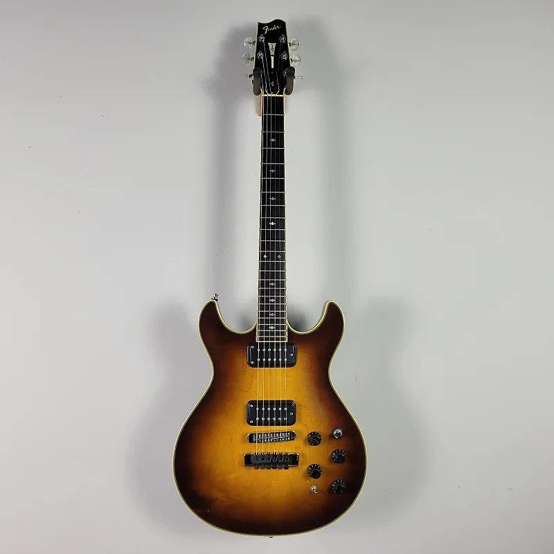

nuke Posted May 6, 2024 Posted May 6, 2024 Honestly, what pickup winder offers a low-moderate output conventional humbucker that isn't claimed to be a "PAF clone". 🤔 Schaller made an enormous number of pickups, and an enormous *variety* of pickups. There's not just one Schaller humbucker sound, there are a huge number of Schaller pickup variants, all made to order for different guitar manufacturers. Here's one of my favorites, a 1984 Fender Esprit Elite, part of the "Fender Master Series", the Esprit, Flame and D'Aquisto. Robben Ford played the Esprit, and Fender eventually re-launched it as the Robben Ford signature series. It's a really nice guitar, made in Japan and supervised by D'Aquisto. These were the first with Fender's "TBX" tone control system and intended as very high-end instruments. The pickups are Schaller, used on all three models. They are definitely on the mellow side, and have a unique mounting system with 3-point alignment, and the top of the pickup has a radius to match the strings. Of course, all the rest of the hardware probably looks familiar, tuners, bridge and fine-tune tailpiece are all Schaller. All of this still works great 40-years later. This unusual pickup system appears in Schaller's OEM literature in the mid-1970's. I'm not aware of another guitar maker who used it. They were not cheap, and quite innovative. I don't know what deal Heritage did with Schaller, or what they ordered or what spec's they asked for from Schaller. But they could have ordered whatever they wanted from them.
