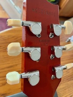

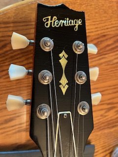

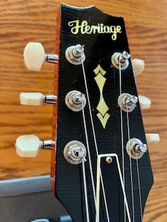

My 150 Artisian Aged Custom Core has been a labor of love in modifying it to how I wanted it to look and sound.  Like the theory behind the 150 CC, I used a '59 LP Burst as my inspiration.
-Some of the mods were merely just personal choice;                                                                                                                                                                                                                                      1) I greatly prefer A2 magnets over A3 magnets so I installed a used set of Throbak SLE 101s pickups with aged covers.                                                                                                              2) I like the look of the Rhythm/Treble "poker chip" pickup selector                                                                                                                                                                                                      3) I replaced the orange drop caps with the same values in repro Bumble Bee paper & oil caps                                                                                                                                                                                          4) For consistency in pot values and taper I installed RS Guitarworks 500K volume and tone pots
-Some of the mods were just necessary functionally;                                                                                                                                                                                                                                       1) the bridge studs and the stoptail studs were drilled at an angle instead of straight into the top from the factory so the  TOM bridge & stoptail wouldn't lower completely.  So a Faber locking ABR bridge and Faber locking StopTail studs were used to fix the original off angle bridge & stoptail studs.                                                                                                                       2) three of the aged tuners stripped and became useless.  I replaced them with CHROME (I couldn't find Nickel ones which I would have preferred) Gotoh tuners that were a direct drop in, lighter, and had improved tuning ratio.  .... BUT WAIT, A MAJOR UPDATE ON NEW AGED NICKEL FINISHED GOTOH TUNERS....
SO... the last 150 CC mod/improvement was buying on Ebay some new Antique Nickel Finish Gotoh tuners.  To me, the Chrome on the Gotohs tuners was a complete eyesore with the aged finish of the rest of the 150 CC.  These new Antique Nickel Finish Gotoh tuners were not cheap ($110 + shipping) but to me they were the final piece in the puzzle to getting my Aged 150 CC to look close to Vintage LP Burst.  (I also added some Kluson-like tuner buttons to finish the transformation)

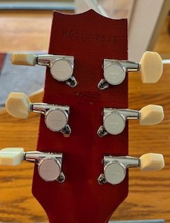

BEFORE with the CHROME GOTOH tuners
Chrome1.jpg.63ef84d282af17195de8ad99b876991c.jpgChrome2.jpg.3e26d052d881f12c210333fecc41312f.jpgChrome3.jpg.82ef3732e42db342dafd42c6e9b19f38.jpg

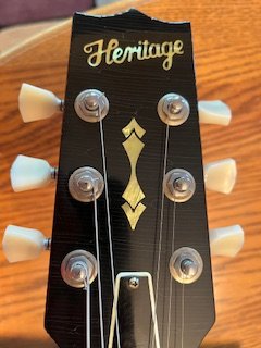

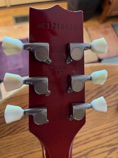

AFTER with the new ANTIQUE NICKEL GOTOH 510 tuners
Nickel2.jpg.4a44ab2f025e29586f374548b57b4992.jpgNickel1.jpg.ff55246a2f8156d81ff5b1ecc5d6638d.jpgNickel3.jpg.c02c8626b32f58d889493824d6b072f8.jpgNickelpackage.jpg.69889994c4fb747599dd9d068c952a5a.jpg

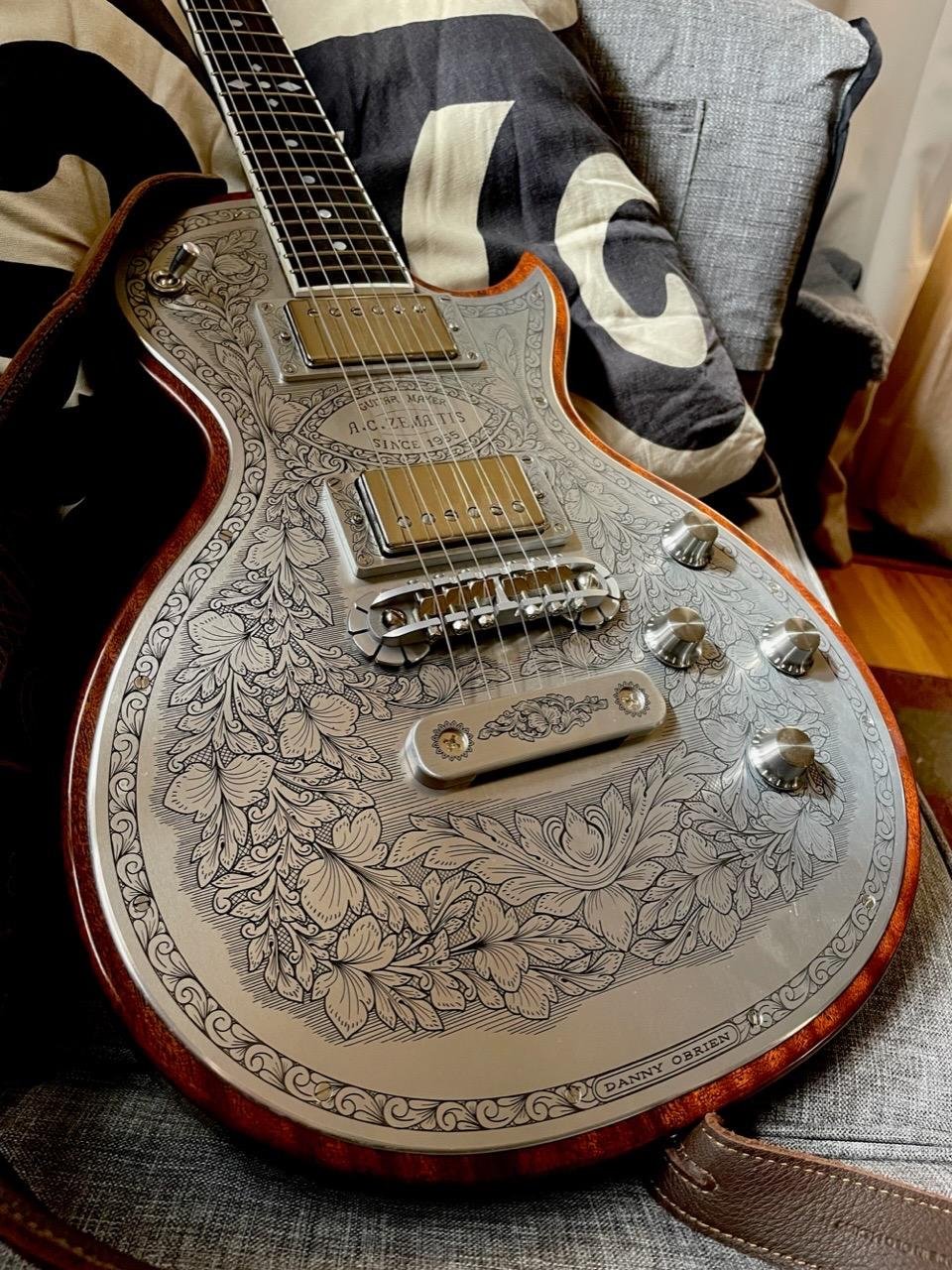

5 hours ago, rockabilly69 said:
Are you saying you're going to put a Nashville Faber on your guitar??? I have never heard a guitar go from an ABR bridge to a Nashville and sound better. And as I've said in many earlier posts, I've worked on 100's of guitars. I love Faber bridges, and as Kuz will tell you, I hipped him to them. I especially like the brass saddle tone lock bridges. I have them on both of my H150s, my H525 P90 (that Kuz sold me), and my Firebird. Every single time they cleaned up the low end and gave me a more balanced tone. On every one of these guitars they replaced a Nashville! Another benefit of the ABR is that could always get the tailpiece into it's sweet spot (low to the body) without having the string hit the back of the bridge.
And besides the guitars that I still own. I replaced the Nashvilles on two other Les Paul Specials, an SG Classic, and a Firebird. And all of those sounded better with the Faber ABR. I only ever had one bad experience with Faber with an ABR that sounded dead. But a few weeks after I installed it I got a letter from Larry Corsa and he told me mine came from a bad batch and that he would send me a new one. I never told him about my bad bridge!!! And the new one was great. Now that's customer service!
If you want a great set of pickups with the jazz/jb vibe, pair a Wolftone Legend in the neck with a Wolfetone Fenris in the bridge. Same vibe better tone. If your guitar is dark try a 0.15uf cap in the neck, and a .022uf in the bridge. If it's bright, try .022uf caps for both the neck and bridge! 500K pots all the way round!
That's the setup in this guitar and it rules, I love having the ballsy bridge pickup...
Thanks Rockabilly ! Nice Zemaitas !

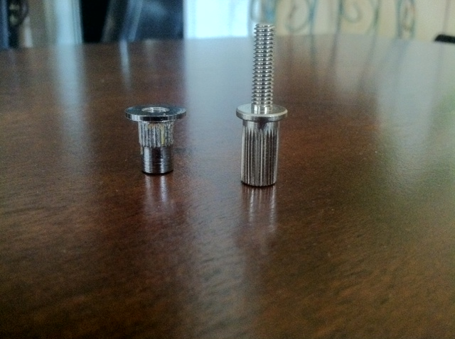

Actually just the opposite, the cap plays a bigger part in the sweep but not when it's wide open. The 490R/498T setup is tried and true, but I would use an .015 cap on the 490R for the clarity but more importantly, it's perfect for the woman tone when the tone knob is rolled off!
As for the NSWkit I have never used that alone, at first I used Faber inserts which were far better than the stock Gibson and Heritage inserts.
Difference very clear here, stock inserts in the left. Faber German steel, Gibson/Heritage pot metal!
And than I used the BSW kit in one of my H150s and I heard a difference. Kuz also had the BSW kit installed in my H535 P90 (once again, thank you Kuz!!!)

Were the nickel 510 tuners you picked up considered the “Mini” variety?
