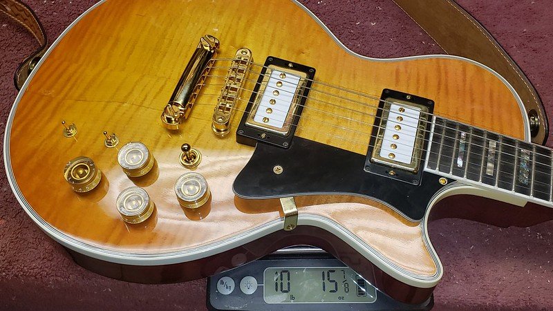

MartyGrass Posted July 4, 2024 Posted July 4, 2024 Four wire pickups allow the toggle switch to take you from the standard output, single coil, and out of phase. This vintage sunburst example does this with two SD P- Rails. The advantage of these pickups is that when you split the coils, the open coil can be the hotter one, like a P-90. Standard humbuckers split weakly. Also, you can select the weaker coil, which gives more of a Fender single coil sound.
