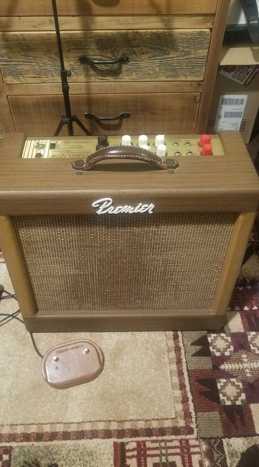

rwinking Posted July 15, 2024 Author Posted July 15, 2024 I picked it up to try and it is a cool amp. One issue is that as I turn up the reverb knob I get more gain. It is a great growly gain, but it is reverb saturated. Hmmm. I am having a friend check it out. For $500 it seems like a great deal and I don't think the reverb issue will be too much to correct. The reverb unit comes out of a hinged back panel so the speaker doesn't shake it. The tremolo is wonderful. As you can see from the pix, it has this cool tacky vibe with a way cool footswitch and brown, red and white bakelite knobs.....

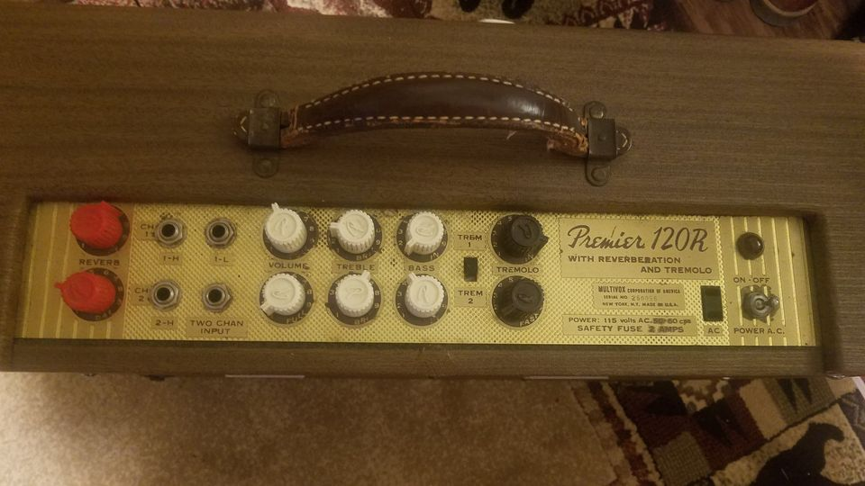

rwinking Posted July 15, 2024 Author Posted July 15, 2024 The reverb is out on Channel 2 so I am not sure. At this point channel I & 2 have about the same amount of volume/gain. I am not sure about the tubes yet. I am taking it in to an old tube fanatic who will check out all of these issues. From what I have read online, there are no schematics out there, but he said that he worked on one a couple of years back. In the picture you can see the cool brown footswitch, It also came with the original brown cloth cover.
bolero Posted July 15, 2024 Posted July 15, 2024 That looks pretty sweet. I was wondering if the 2ch input worked like 4 hole marshalls, so you can blend them together. It appears to have 2 separate preamps, which opens up other possibilities. Congrats!
rwinking Posted July 16, 2024 Author Posted July 16, 2024 On 7/14/2024 at 9:03 PM, Gitfiddler said: Cool looking amp. What's the tube set? If it has a reverb driver (12ax7?) maybe it needs replacing. So I had it checked out and the tubes are 2 6V6 pwr tubes 3 12 ax7 preamp tubes 6AQS reverb tube 5Y36T rectifier tube I don't think the rerb is meant for both channels as it tuens out. The second reverb knob says Balance and it changes the nature of the reverb. The tremolo is in both channels but you have to flip a switch between the channels. The EQ is interactive, similar to an AC30 where subtracting bass adds treble, etc. All and all, a cool amp for $450...I got him down $50..... It's pretty spotless!
bolero Posted July 16, 2024 Posted July 16, 2024 Funky! Does the trem work in both channels at the same time?
rwinking Posted July 16, 2024 Author Posted July 16, 2024 I don't think so as there is a switch that goes from channel one to channel two on the trem
