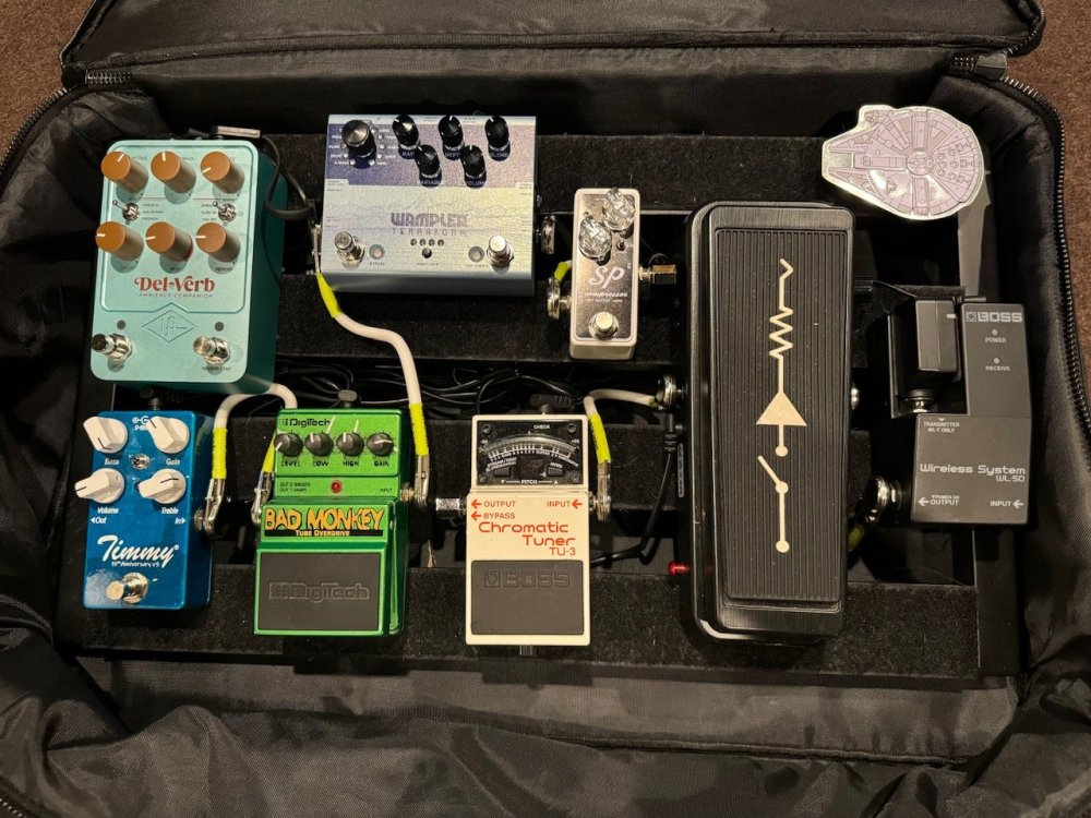

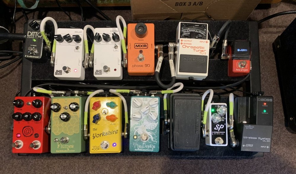

DetroitBlues Posted November 27, 2024 Posted November 27, 2024 (edited) Just to build off my previous thread, here’s a before and after of my pedal board adventures. With exception to the noise suppressor, I am able to achieve the same tonal options with less pedals… The Wampler has a pre/post input/outputs, similar to an effects loop. I have programmed some effects like Phaser and Univibe to be in front of the amp/gain pedals. Others such flanger, chorus, etc are post gain that I have running through the effects loop of my amp. The Delay and Reverb combos also run from the post output so they are also outside of the gain stages. Edited November 27, 2024 by DetroitBlues
bolero Posted November 27, 2024 Posted November 27, 2024 That looks more elegant for sure! So you have more pedals by your amp? Or the wampler does all that?
Anthony Posted November 27, 2024 Posted November 27, 2024 Does the Falcon do anything besides look effing cool?
DetroitBlues Posted November 27, 2024 Author Posted November 27, 2024 1 hour ago, bolero said: That looks more elegant for sure! So you have more pedals by your amp? Or the wampler does all that? Wampler does all that.
DetroitBlues Posted November 27, 2024 Author Posted November 27, 2024 1 hour ago, Anthony said: Does the Falcon do anything besides look effing cool? Yes. It safely guards my plectrums from the evil galactic empire.
