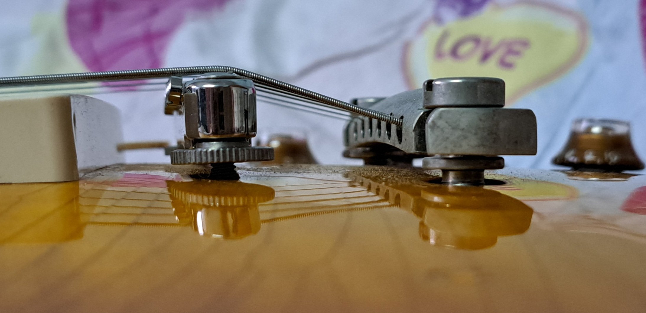

hopkinwfg Posted January 2 Posted January 2 (edited) Thought it be nice to share some pics... but Heritage purist sorry i took it a step further... in my opinion its nicer now and the H150CC hardware sucks... especially tuners... ouch Like the H150CC everybit but if Heritage could reconsider to up their game closer on the hardware and frets it be top notch !! Apologise yes i should have file down the string notch on the saddles... but have not tried it before could need some time and practise Edited January 2 by hopkinwfg

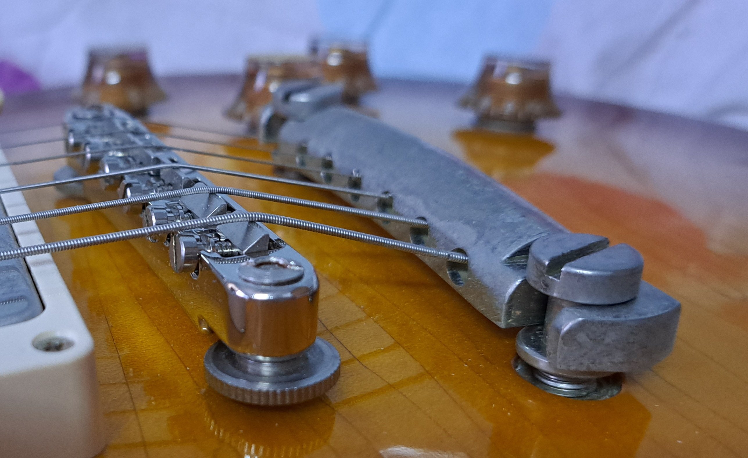

hopkinwfg Posted January 2 Author Posted January 2 (edited) Pic of the side... sitting well on the API thumbwheel... seriously any comments? Is the bridge too high? just a 5.5mm hole enlarge and a chamfering flute Edited January 2 by hopkinwfg
nuke Posted January 2 Posted January 2 Have to say, I’m a very big fan of Faber locking bridge and tail piece and Gotoh SG301 locking tuners. Lighter, sound great, much lighter and far more practical to live with. Nylon nuts too. Same as the late 1950’s Gibson ‘bursts and other models from the golden era. Better than bone. 1
Kuz Posted January 2 Posted January 2 On 1/2/2025 at 4:46 AM, nuke said: Have to say, I’m a very big fan of Faber locking bridge and tail piece and Gotoh SG301 locking tuners. Lighter, sound great, much lighter and far more practical to live with. Expand That's what is on my 150CC; Faber locking tuneamatic and locking stoptail hardware, and Gotoh aged drop-in tuners. They are a MASSIVE upgrade.

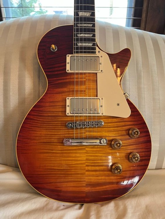

Jimbob Posted February 28 Posted February 28 On 2/28/2025 at 3:02 AM, bolero said: Hey congrats & cool beans. That's a really nice top!! Expand Thanks! I just had to grab it when it came up for sale a couple of weeks ago: 1
Spectrum13 Posted February 28 Posted February 28 On 2/28/2025 at 3:40 AM, Jimbob said: Thanks! I just had to grab it when it came up for sale a couple of weeks ago: Expand Brockburst much? That's the ticket! 1
Jimbob Posted February 28 Posted February 28 (edited) On 2/28/2025 at 3:43 AM, Spectrum13 said: Brockburst much? That's the ticket! Expand Ha! I had to look that up to see what the Brockburst was all about out, but yeah, I thought that the flamed-maple was pretty amazing on this one. It's even nicer better in person and, thankfully, it sounds pretty sweet, too! It's getting heavily modded, though. The next mod is a tuner swap. Edited February 28 by Jimbob
