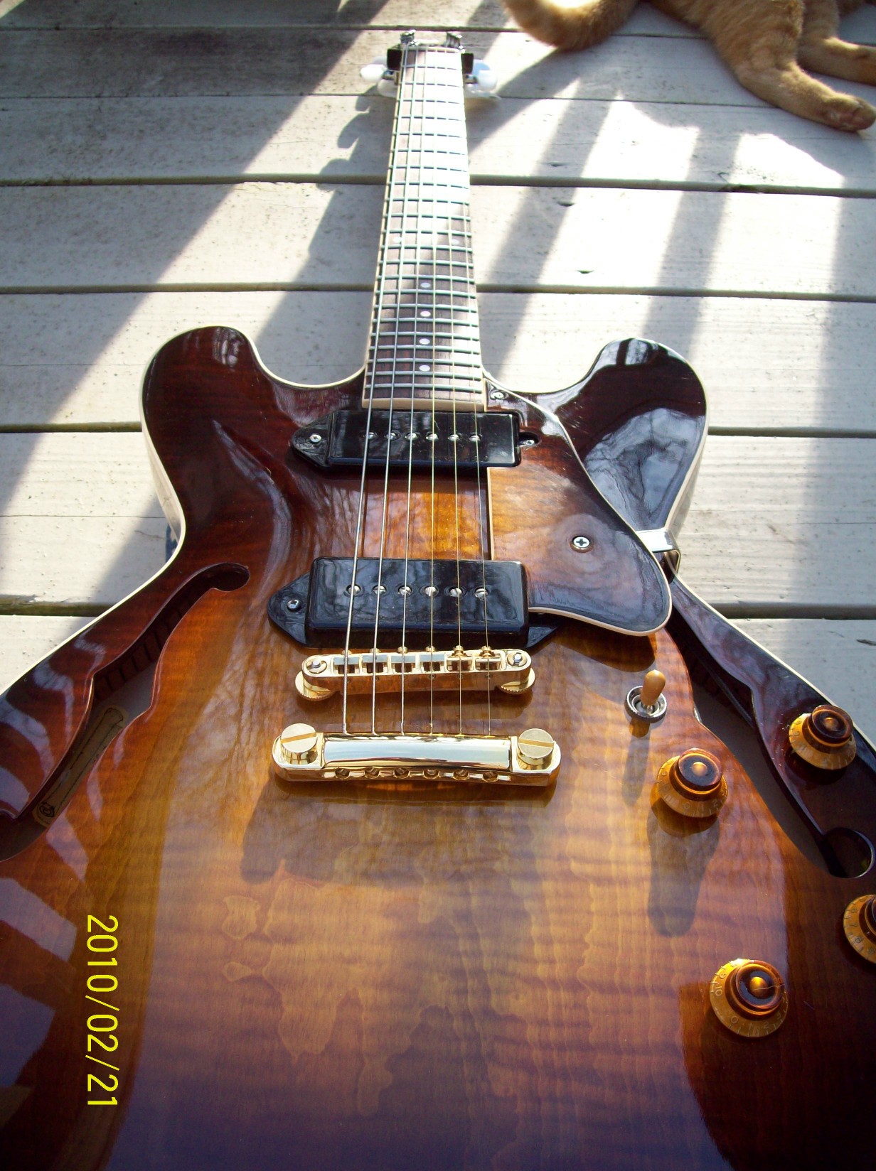

H Posted April 16, 2010 Posted April 16, 2010 Very nice 535 by the way I'm not normally one for gold hardware but the finish on yours sets it off beautifully
Spectrum13 Posted April 16, 2010 Posted April 16, 2010 Thanks H, It's a Prospect and had chrome Faber bridgeposts and tailpiece from the factory. I don't like gold either but OCD made me change it out for that old style burst finish. Don't know the part number for Faber in UK, I ordered from CVGuitars - Larry Corsa in the USA appears to be the distributer here.

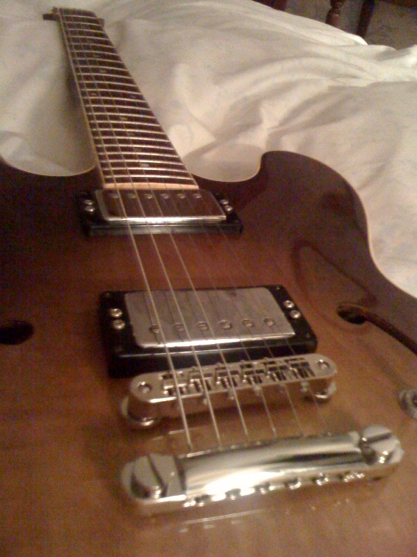

H Posted April 27, 2010 Posted April 27, 2010 H said: I've got mine in the post already And now they're fitted - very easy to do and looks great Minor improvement in tone but definitely better sustain across all strings. Pics of before and after are in my gallery - apologies as they're just from a camera phone at present, better quality pics coming soon I've got a set of TonePros Kluson cream tulip tuners in the post now - more pics when they are on.
