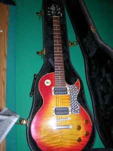

Axman Posted June 8, 2009 Posted June 8, 2009 I local is selling one which he agreed to let me have for $650. I was wondering is this is a good price, of course contingent on condition. The best I know of it is that it was built in 1986. He doesn't know what kind of pickup are on it but says they are stock. Does anyone know what sort of pickups were most likely stock on that model in 1986? I'm anxious for a new addition to the family, already have a 140-P but imagine this will sound different than the poplar version. Les Paulish like a 150? That pickguard doesn't look stock, but my 150-P came with a weird wooden one that looks odd on a black guitar.
brentrocks Posted June 8, 2009 Posted June 8, 2009 looks like it has the stock Schaller pups in it...nice top and that price seems really good if it isnt beat to crap good luck
Axman Posted June 8, 2009 Author Posted June 8, 2009 Thanks, I think that's what's in my 140-P if I recall right... never saw a reason to swap them out. I'm check the condition.. funds are low but if that's a great price I think I can convince the wife it's an "investment"... I pretty much say that about all my equip and never sold a piece.
Axman Posted June 8, 2009 Author Posted June 8, 2009 LOL... it's not the original he emailed me.. Um... yea, it's a bit gaudy.
tulk1 Posted June 8, 2009 Posted June 8, 2009 An '86 H-140? Second full year of production? Grab it!! You'll def hear a difference between this one and your 140P. The 140CM (Curly Maple) was Heritage's first solid top LP-market guitar. Yeah, you'll get some good tone that you can't get with the poplar body. BTW, Heritage finger rests (uh, pick guards) are wooden. Generally a very nice maple figuring, too. Even if it's painted black. Just thought you should know.
Gitfiddler Posted June 8, 2009 Posted June 8, 2009 Before you close the deal, be sure to take a look UNDER that pick guard monstrosity. It could be hiding something.
Kuz Posted June 8, 2009 Posted June 8, 2009 Before you close the deal, be sure to take a look UNDER that pick guard monstrosity. It could be hiding something. A disco ball, a bass boat, silver naked ladies &/or "Back Off" mudflaps, ect....

smurph1 Posted June 9, 2009 Posted June 9, 2009 How quickly can you rip that pickguard off?You got that right!! Beautiful flame though..

slider313 Posted June 10, 2009 Posted June 10, 2009 I'm not sure I believe the story. The bridge and tailpiece hardware from an '86 H140 would be Schaller. This guitar has what looks like a Nashville bridge and Gibson style stop tail.
