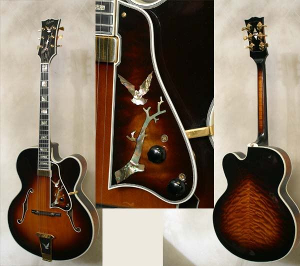

DC Ron Posted June 22, 2009 Posted June 22, 2009 The Eagle Classic is closest to an L5-CES, with 17" bout, carved spruce top, mounted pickups, and, I believe, parallel bracing. The Golden Eagle is more like an old L5C or Johnny Smith. Like the Classic it has a 17" bout and carved spruce top. However, it has X-bracing and a floating pickup like the Johnny Smith. Unlike that guitar, it does not have a special 25" scale. Yoslate and I have the 18" Super Eagle, which is similar to a larger Eagle Classic and is to die for. Exactly right. The Eagle Classic has parallel bracing and is like an L-5CES with a bit less binding. BTW, I've got a Super Eagle on the way with X-bracing and floating pickup. Photos shortly...

111518 Posted June 22, 2009 Posted June 22, 2009 Very pretty, DC. Randy: One tidbit. From mid60 until 68-9, L-5s and Super 400s had pointed (Florentine) cutaways and laminated backs. If your friend's L-5 is from the 60's, its construction is probably quite different than any of the solid wood/rounded-cutaway Heritage guitars. My friendly contribution to the discussion about model features .... My Eagle Classic has a floater and is X-braced, so I'm guessing the parallel bar/X-brace distinction for Heritage spruce archtops is not about the model but about whether or not it leaves the factory with a floater or mounted pickups. This is interesting, since Gibson went from the X to parallel bars on the L-5 and 400 before those guitars got pickups. If we are connecting specific models rather than locations in product lines, I would argue that the Golden Eagle is the successor to the Gibson Kalamazoo Award. I can't find any information about how it was braced. My 2 cents, of course.
DC Ron Posted June 22, 2009 Posted June 22, 2009 I 110% agree that the GE is closest to the Kalamazoo Award. When I bought my GE new at a show, the dealer had a Kalamazoo Award, and the GE was just flat out better looking. This one is supposed to be X-braced, and I'd bet they all are. Love the inlayed pickguard!

Jazzpunk Posted June 25, 2009 Posted June 25, 2009 My Eagle Classic has a floater and is X-braced, so I'm guessing the parallel bar/X-brace distinction for Heritage spruce archtops is not about the model but about whether or not it leaves the factory with a floater or mounted pickups. This is interesting, since Gibson went from the X to parallel bars on the L-5 and 400 before those guitars got pickups. If we are connecting specific models rather than locations in product lines, I would argue that the Golden Eagle is the successor to the Gibson Kalamazoo Award. I can't find any information about how it was braced. My 2 cents, of course. Holy cow, that is one sharp lookin guitar! What's the story? Is this guitar pre-'Official' Heritage and still under the Gibby label?
111518 Posted June 26, 2009 Posted June 26, 2009 Jazzpunk: Check out Jay Wolfe's post about the connection between the Kalamazoo Award and the Golden Eagle: http://www.heritageownersclub.com/forums/i...?showtopic=5102
