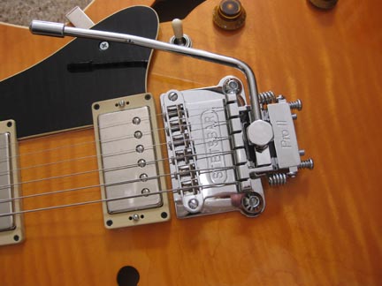

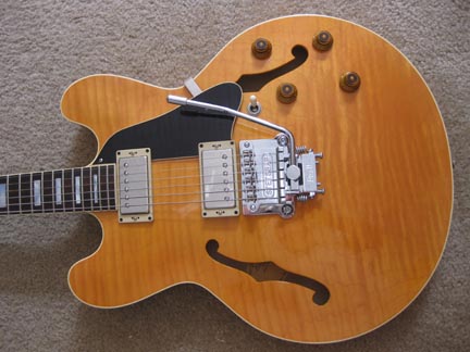

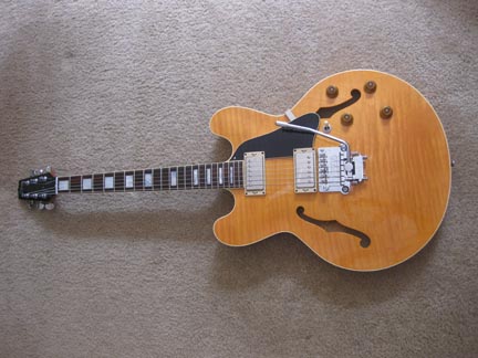

macteacher Posted May 29, 2010 Posted May 29, 2010 Hi, First off, for my first post on the forum, a big thank you to everybody for the useful information that I've found here. In that spirit, I wanted to share my experience with recently having a Stetsbar added to my Heritage 535 successfully. First I exchanged a few emails with Eric Stets including one with measurements and pictures that I took with the bridge and stop tail piece removed. I also included a ruler in the shots. I also provided him with the distances between the middle, inside, and outsides of the posts of the bridge and stop tail piece as well as the distances from the pickup casing. He thought that my 535 was within tolerances of what the Stetsbar was designed for, based on my measurements, and even recommended what Stetsbar finish I should order to match my guitar. (chrome) He used to make creme colored bases for the Stetsbar which I noticed in his gallery, which would have matched my pickup bases, but he no longer carries these. (In hindsight the chrome is a better choice I think, the creme would have been too "matchy-matchy") After receiving the unit, I took it to Andy Brauer, a top tech who's listed on the Stetsbar site as a dealer for the installation. Eric Stets's return policy stated specifically that a guitar tech had to install the Stetsbar to be returned. From what I had read online, I think that this is well founded. I'd read a number of posts from folks who had self installed the Stetsbar, that they had a wide scope of experiences with the installation and the result. I figured that since the unit wasn't specifically designed for a Heritage, and we might be stretching the intended tolerances, it would be better to take it to a great setup guy who also happened to be Stetsbar dealer. I also had locking tuners installed as I had read that it's a good idea on tremolo systems in general. In the spirit of complete disclosure, there was one small bridge saddle imperfection with the unit that was found by Andy Brauer, my installer, but the bridge was quickly replaced by Eric Stets, which I think speaks to the quality of Eric's customer service. Andy also installed the new bridge without an extra charge, also great customer service. I also must state that it's been a while since I had the guitar properly setup. Also worth mentioning is that for strings I had the setup up done with 11s. I was playing heavy with 12s, but Stetsbar's FAQ recommended no heavier than 11s. The result? First off, as expected, Andy Brauer did a great setup. (He's been the guitar tech for Al Di Meola on tour as well as numerous other top players.) When I first sat down with the guitar I was playing too heavy causing string noise, but once I settled into a lighter touch and the new action, it was nice. Once the new strings stretched in after a day, I found the Stetsbar to return the strings to tune quite nicely. You can tap on it just like a Bigsby for a quick bend and the strings come right back to tune. After a few days of playing lightly, I switched the 11s out with a string set of 10s just for fun. With 10s, bending down on the low E string, I can go to a Low B with the bar down pushed down to the pick guard. Bending up the low E up, I can go to an A with a strong pull. This being said, I'm not sure how often you would actually use these extreme bends in the course of playing. My opinion is that you'd definitely be stretching the strings themselves past what they were designed for, and tuning would quickly become an issue that has nothing to do with your guitar and tremolo system. I also have to say that changing strings was a breeze, even easier that threading the stop tail tailpiece. You just drop the ends of strings into the Stetsbar. Nice. All in all, I'm very satisfied with the system so far. The bends are smooth and the action of the unit is engineered very nicely. Tone-wise on my guitar and with my setup, I don't see a significant difference from before the Stetsbar. Granted I'm playing lighter strings with a lighter touch and a world-class setup, so I'm not digging in as much. The bottom line is that I wanted a tremolo bar. So if any tremolo bar, no matter which, is going to be a "tone sucker", as some folks have stated, that's the price of admission. And speaking of price, the whole installation and setup was an investment, between the locking tuners, Stetsbar price and the installation and setup. But I also wanted a reversible tremolo option and wasn't interested in altering the guitar with a Bigsby mount. I did briefly look at the Vibramate which had many good reviews, but I felt the Stetsbar fit my personal purposes better, especially after the personal service that I received from Eric regarding mounting the Stetsbar on a Heritage. That's my Stetsbar experience. I hope it benefits someone else. nice unit.
