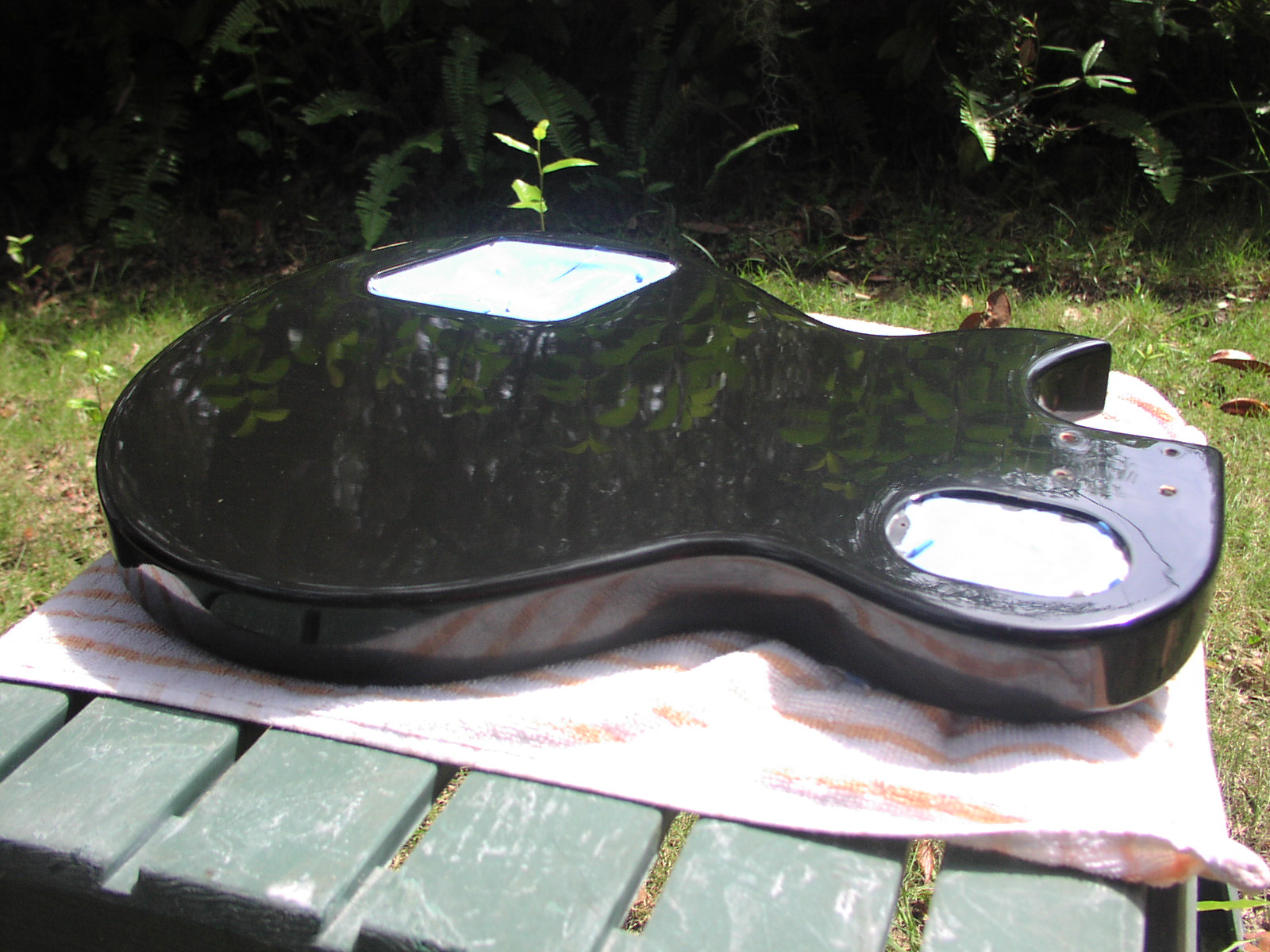

big bob Posted September 11, 2009 Author Posted September 11, 2009 I had some time to try the buffer and some rubbing compound on the back, it did ok but still a lot of scratches and the lacquer checking was real prominent. So I busted out the 2000 grit wet paper and some turpentine and sanded her down, then buffed her out a second time, the scratches are gone the lacquer checking is there but feint, I'm hesitant to sand any more as I don"t want to go through to wood. I plan on wet sanding the sides and front and then a buff out. Hopefully I will be happy with her at that point but if not might consider a new lacquer job. the neck on the other hand buffed out great.. I could not be happier with it.

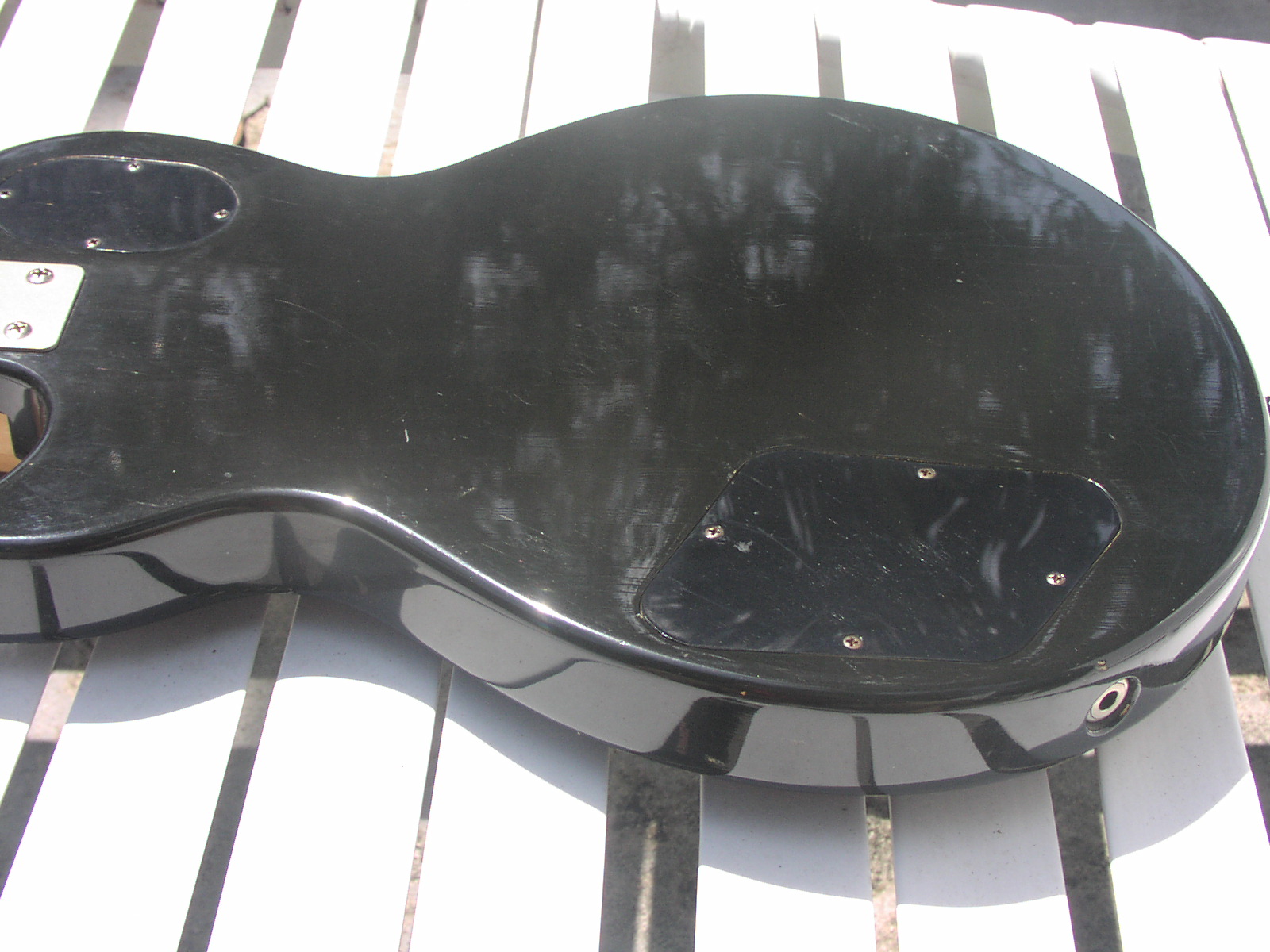

big bob Posted September 11, 2009 Author Posted September 11, 2009 more, shows the checking before and now.
DC Ron Posted September 11, 2009 Posted September 11, 2009 +1 on the guard dog. I like checking too, as long as it's the pretty kind you've got there. I wouldn't change it. Adds grunches to the "this is a cool old guitar" factor. I think if you put this back together more or less the way you got it, with a setup, it will be superfine...

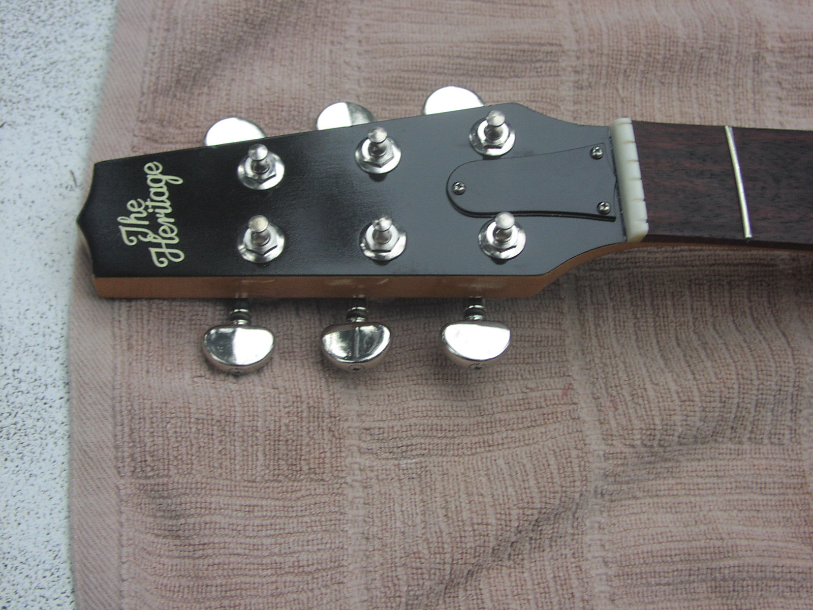

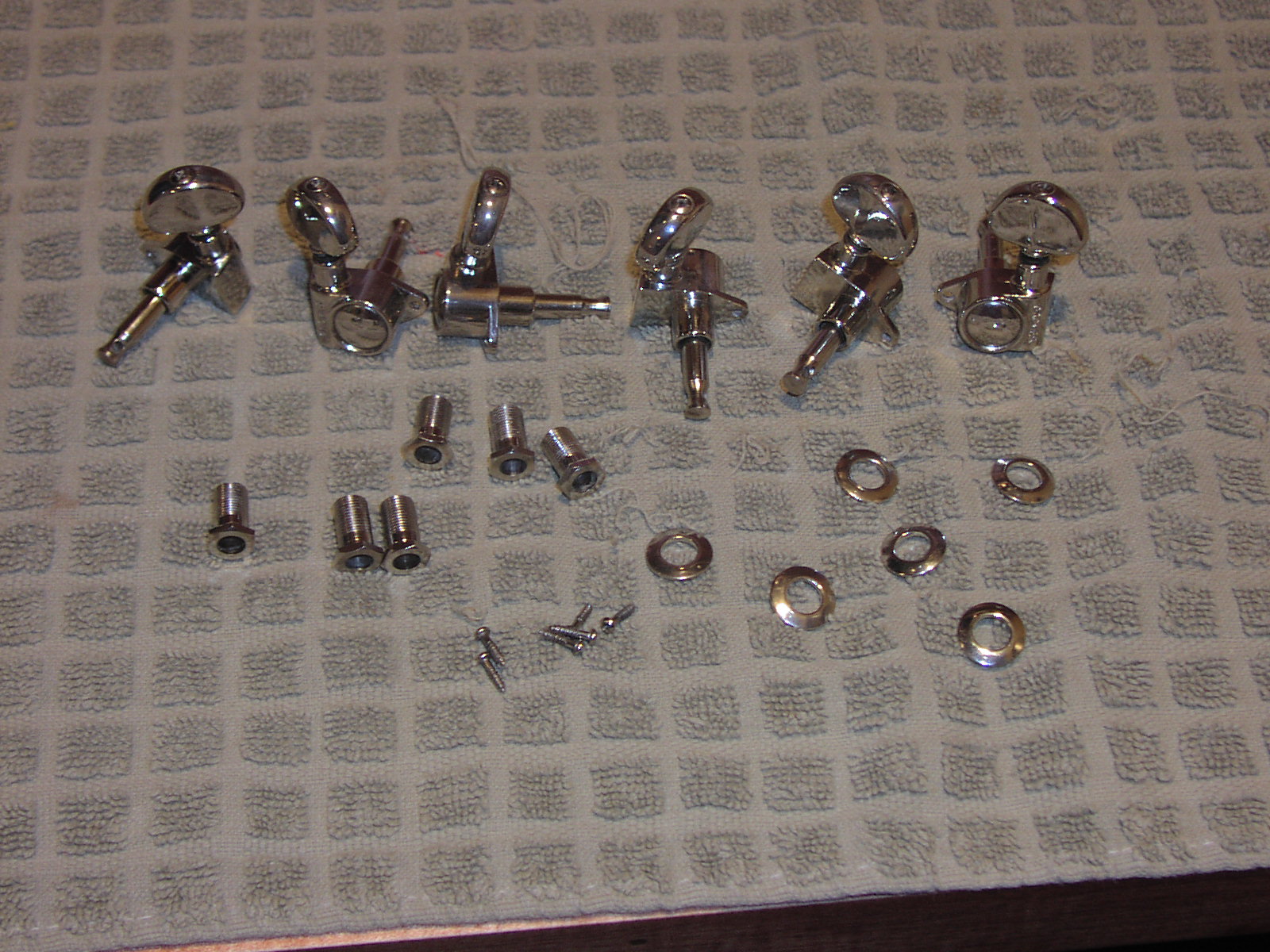

big bob Posted September 12, 2009 Author Posted September 12, 2009 the neck is done.. and it turned out 100 % better than I ever would have hoped. the neck is straight as a can be with almost no truss rod adjustment just a hint of relief. The headstock and neck buffed out beautifully the hardware cleaned up great, I even polished the screws. the rosewood board is nice and deep and the frets have some ware but very minimal. over all a super cool three pc neck.
