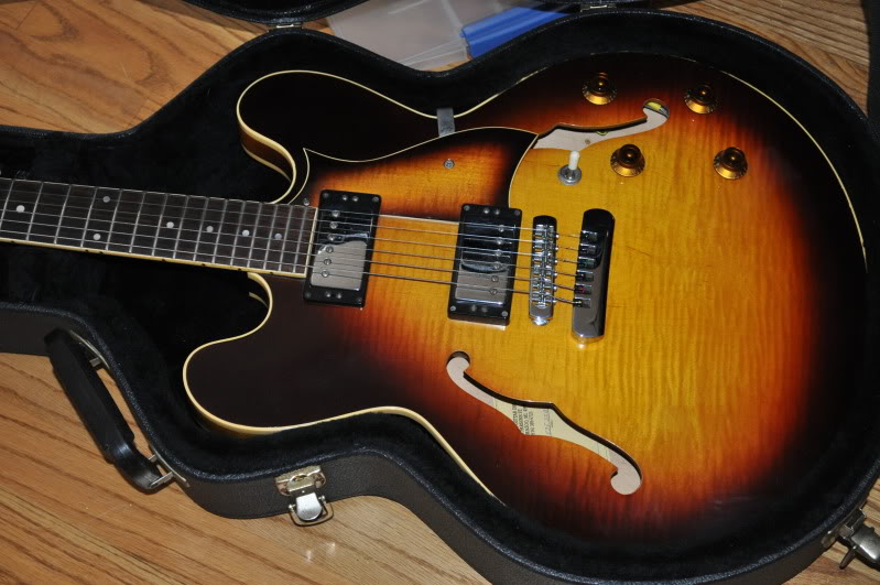

bbjonz Posted January 9, 2010 Posted January 9, 2010 Just received my '96 535 and it has the Schaller roller bridge and tailpiece--pic below. My '99 535 has the standard Nashville bridge and tailpiece. I think I want to put the Schaller Nashville bridge/tailpiece (labeled "GTM" on the Schaller site) on my '96 but I want to double check that it's a direct replacement--I could just use the existing sleeve/bolts that are currently in the guitar and attach the new bridge and tailpiece, right? BTW, I wanted to like the roller bridge but I put .011 flats on it and the low E doesn't sit well in the roller slot--seems like it wasn't designed to handle that type of string. Joe
tyguy Posted January 10, 2010 Posted January 10, 2010 Just received my '96 535 and it has the Schaller roller bridge and tailpiece--pic below. My '99 535 has the standard Nashville bridge and tailpiece. I think I want to put the Schaller Nashville bridge/tailpiece (labeled "GTM" on the Schaller site) on my '96 but I want to double check that it's a direct replacement--I could just use the existing sleeve/bolts that are currently in the guitar and attach the new bridge and tailpiece, right? BTW, I wanted to like the roller bridge but I put .011 flats on it and the low E doesn't sit well in the roller slot--seems like it wasn't designed to handle that type of string. Joe I ordered a comptom stainless steel for my gretsch and am ordering an aluminum one when he gets them in stock.These are beautiful bridges which intonate well with no moving parts.A work of "art".Check 'em out on his website.If I can use it on my Heritage I will let you know.The difference in tone of brass or heavy metal bridge versus aluminum is incredible.Brass gives mostly the note fundamental with few overtones.Aluminum gives a lot of overtones and less fundamental.It's all a matter of taste but the beauty of it is, this can be changed with different bridges and tailpieces.
bbjonz Posted January 12, 2010 Posted January 12, 2010 The compton bridge looks interesting and I'd be interested in your report on installing it on a Heritage. I got empirical regarding the issue of swapping bridges and it doesn't work. The posts on the TOM bridge are slightly larger than those for the locking bridge tailpiece. So now I'm curious if Schaller makes a TOM setup that's a direct replacement for the roller-bridge setup. Joe I ordered a comptom stainless steel for my gretsch and am ordering an aluminum one when he gets them in stock.These are beautiful bridges which intonate well with no moving parts.A work of "art".Check 'em out on his website.If I can use it on my Heritage I will let you know.The difference in tone of brass or heavy metal bridge versus aluminum is incredible.Brass gives mostly the note fundamental with few overtones.Aluminum gives a lot of overtones and less fundamental.It's all a matter of taste but the beauty of it is, this can be changed with different bridges and tailpieces.

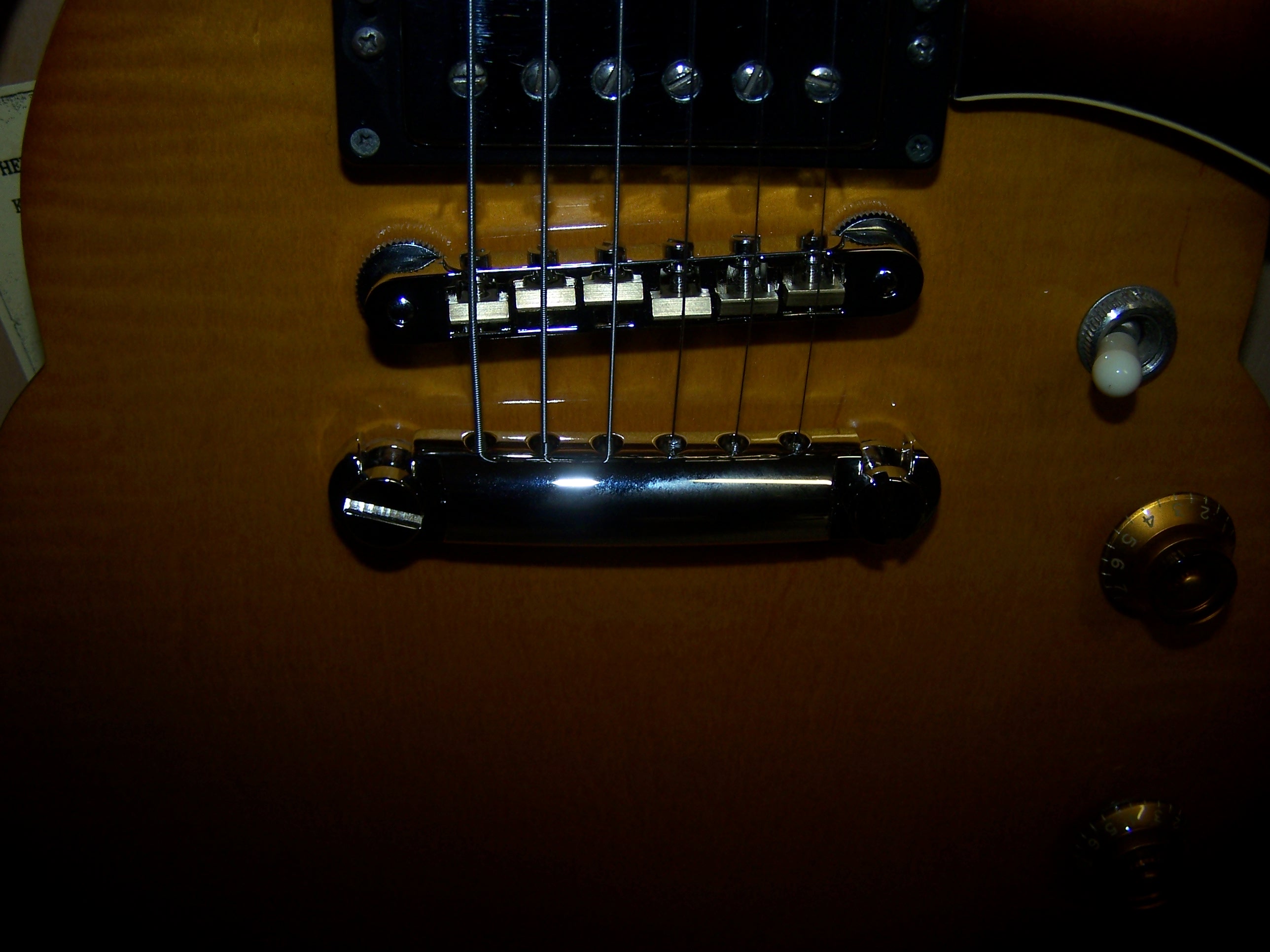

SouthpawGuy Posted January 12, 2010 Posted January 12, 2010 I recently bought a 96 535 in sunset burst with the Schaller hardware and had it replaced with these ... http://cgi.ebay.com/ws/eBayISAPI.dll?ViewI...e=STRK:MEWNX:IT http://cgi.ebay.com/ws/eBayISAPI.dll?ViewI...e=STRK:MEWNX:IT before and after shots before ... after ... The pickups were also changed from Schallers to Duncan P-Rails with the triple shot switching system. =============================
FredZepp Posted January 12, 2010 Posted January 12, 2010 I recently bought a 96 535 in sunset burst with the Schaller hardware and had it replaced with these ... http://cgi.ebay.com/ws/eBayISAPI.dll?ViewI...e=STRK:MEWNX:IT http://cgi.ebay.com/ws/eBayISAPI.dll?ViewI...e=STRK:MEWNX:IT The pickups were also changed from Schallers to Duncan P-Rails with the triple shot switching system. ============================= I notice that the flame on your guitar had more color with the schallers.. brighter, more yellow... (just kidding) It's a beauty, and some nice upgrades there... P-Rails ! But what is involved in the replacement of the bridge and (especially) the tailpiece.
SouthpawGuy Posted January 12, 2010 Posted January 12, 2010 I notice that the flame on your guitar had more color with the schallers.. brighter, more yellow... (just kidding) It's a beauty, and some nice upgrades there... P-Rails ! But what is involved in the replacement of the bridge and (especially) the tailpiece. Thanks ! But what is involved in the replacement of the bridge and (especially) the tailpiece. Answer = I have no clue ! All wiring and hardware work was done by Pete Moreno, courtesy of Brent. I can wire a plug, after that I leave it to the guys that know what they're doing !
bbjonz Posted January 12, 2010 Posted January 12, 2010 That's exactly what I plan to do to mine, at least in terms of bridge/tailpieces. I like the Schaller pups just fine. Turns out there are two sizes for the post bolts for TOM tailpieces, M8 x 1.25 and 5/16-24. I think the metric one is a tad smaller, and that seems what's on my sunburst 535 with the roller bridge, and the larger one is on the red 535. So, after all this, it's off to my tech guy so that he can deal with it... Joe

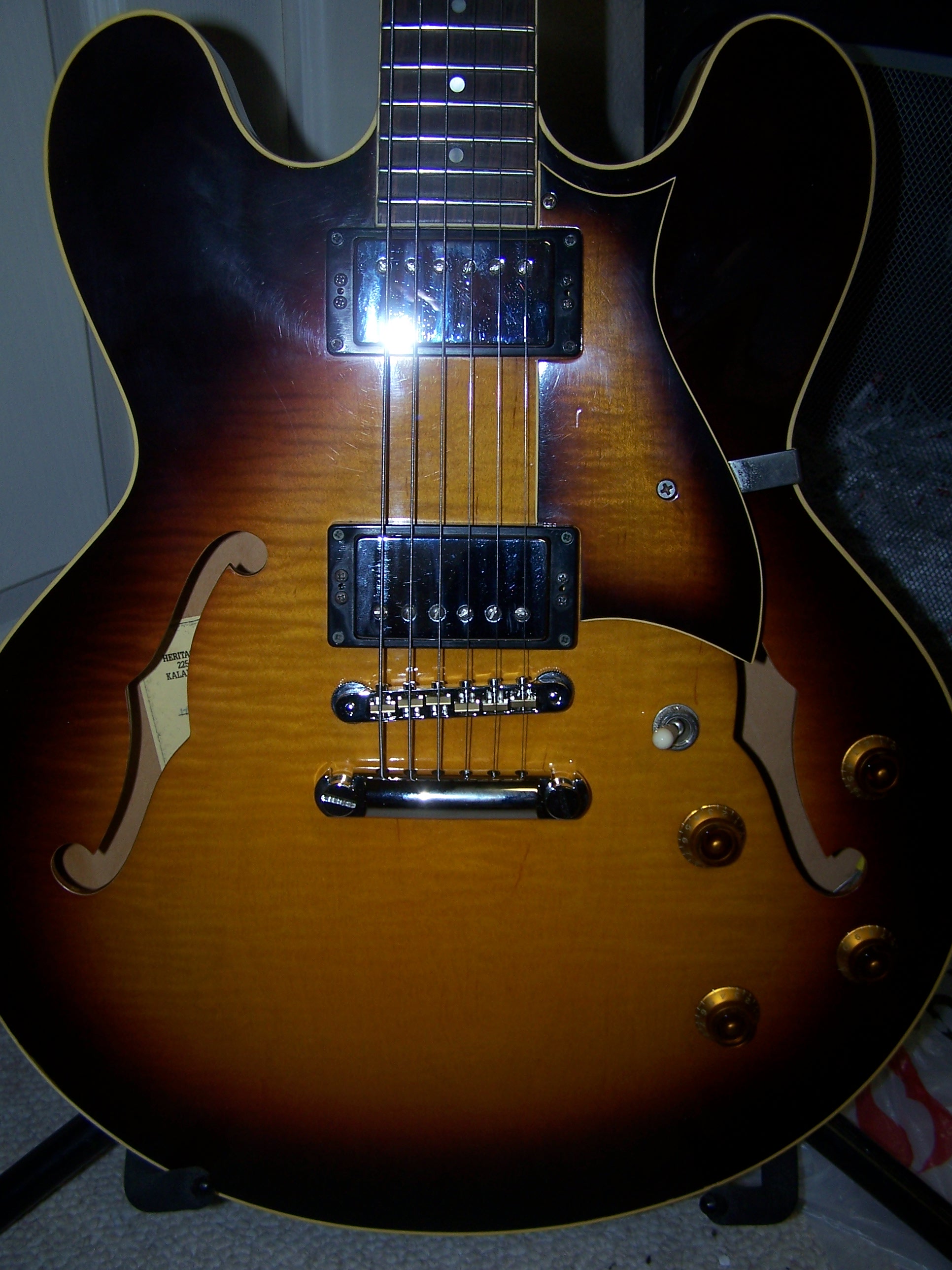

bbjonz Posted January 14, 2010 Posted January 14, 2010 Schaller stuff is well made, but the roller bridge isn't what I'm looking for in terms of tone and feel. I just dropped my sunburst 535 off at my guitar tech, and we found exact replacement TOM parts that fit the existing screw holes for the posts in both the bridge and tailpiece. We tried a bunch of different makes, but it was the one from Allparts that fit -- it wasn't metric, but was smaller than the standard posts that come with most TOM assemblies. So come next week I will have it back with a TOM bridge/tailpiece, a fret dressing, and set up. Can't wait -- it played just fine when I got it, but it's going to be a monster when I get back. Joe

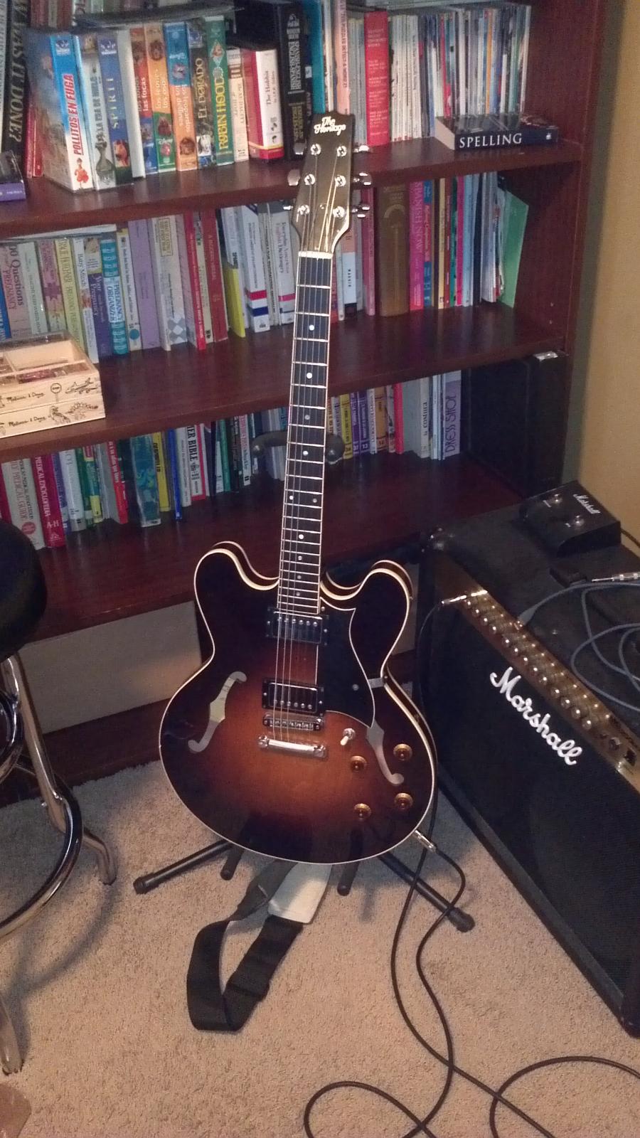

bbjonz Posted January 21, 2010 Posted January 21, 2010 My 535 is back from the shop. The guys at Rainbow Guitars here in Tucson put on a TOM bridge/tailpiece, dressed the frets, and did a setup. Wow--it plays effortlessly! Great guitar. Pics below. And the cleaned the guitar--I didn't know you could do that... Joe
