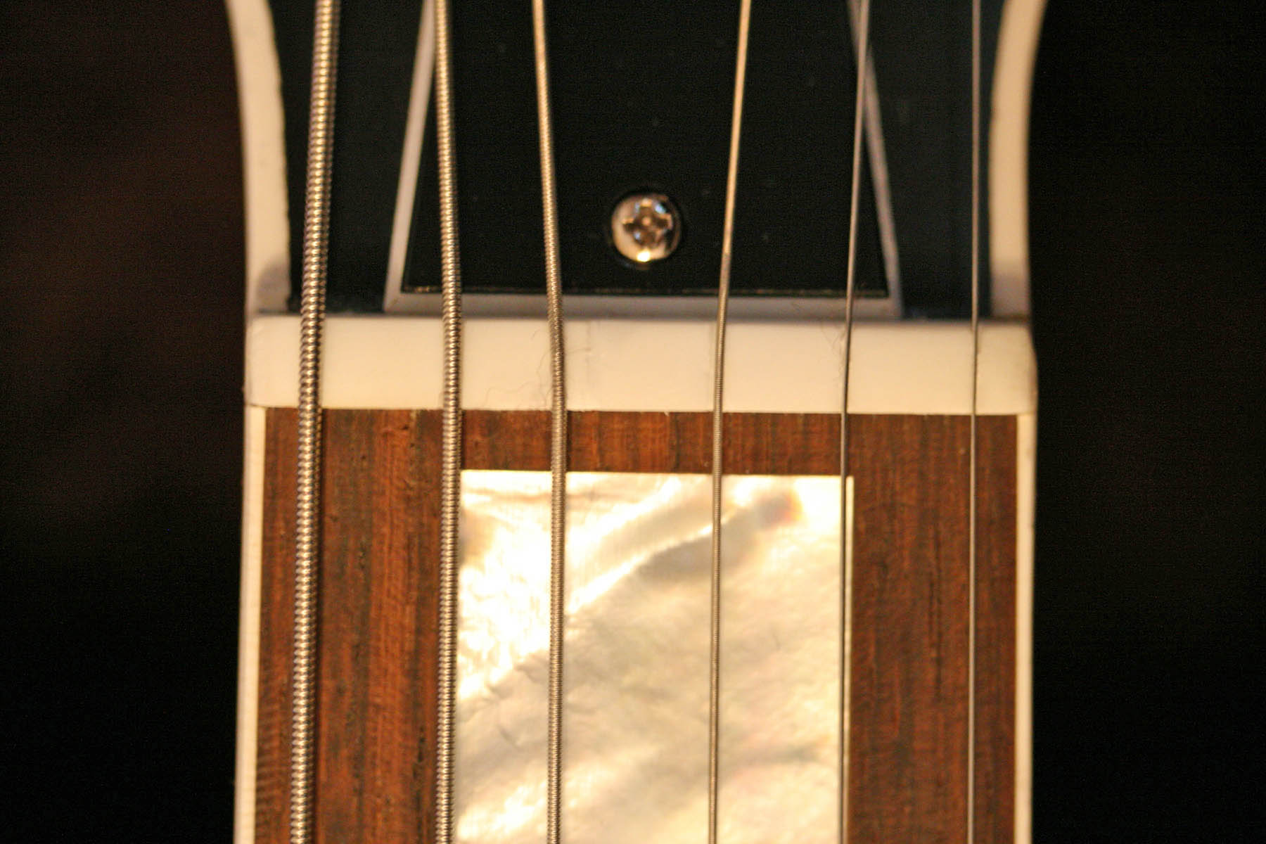

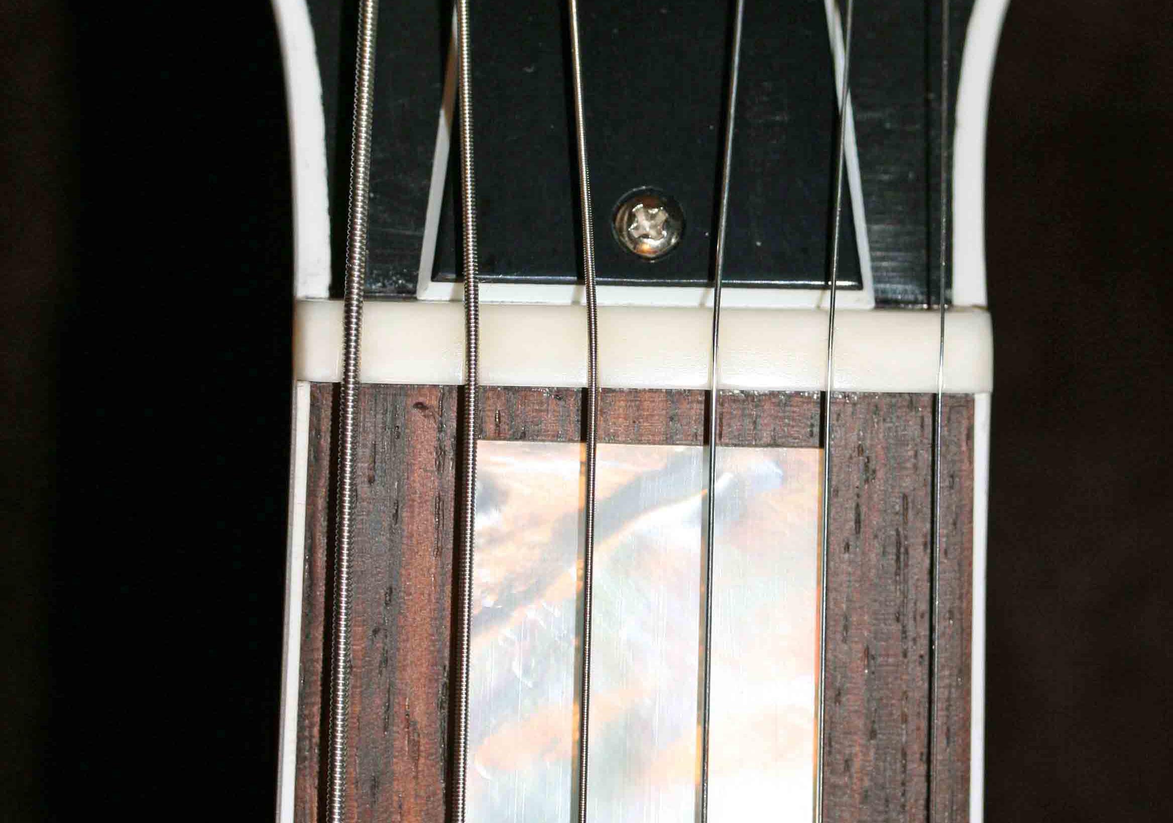

iim7v7im7 Posted January 1, 2010 Author Posted January 1, 2010 Hi, Just some photos: Factory Nut: Replacement Nut: The nut is correctly, string slots sized for the strings, spaced properly and polished to a smooth finish. But note the asymmetry of the strings going to the tuning posts due to their placement. Just like the H555 in the other posting. I will post the plek scans later. I find them most interesting. :-) Bob

PacerX Posted January 2, 2010 Posted January 2, 2010 Hi, Just some photos: Factory Nut: Replacement Nut: The nut is correctly, string slots sized for the strings, spaced properly and polished to a smooth finish. But note the asymmetry of the strings going to the tuning posts due to their placement. Just like the H555 in the other posting. I will post the plek scans later. I find them most interesting. :-) Bob Hmmmm... They do look off a hair. I wonder if they're supposed to be compensated for string diameter. I'd love to see the Plek scans! Oh, here's a good video too... I own a Godin nylon string acoustic/electric guitar synth (say that 5 times fast!!!!)... If'n you want, just skip to 9:30 to see the step that obviously got skipped on yours. Because of your profession (and mine) note all the gauging and fixturing they are using to ensure that neck problems don't exist on their instruments, particularly at ~5:30. Nut problems? Nope. See what happens at 6:35... Because the CNC process is so consistent, they can use a pre-cut nut and can worry a LOT less about getting the slots in the right place. Multiple redundant checks needs to be added into the Heritage process. A rule of thumb in my industry was that any human being checking something will miss a problem about 10% of the time... hence the need for redundancy.
