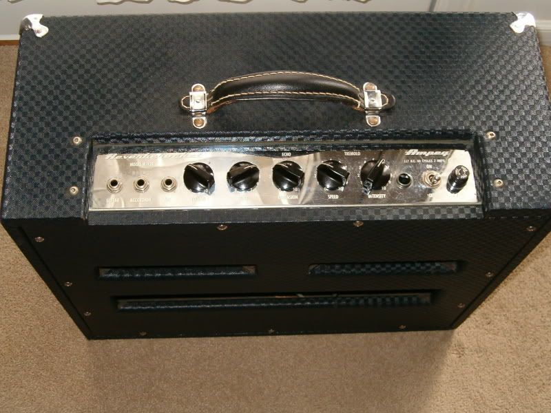

slider313 Posted December 13, 2009 Posted December 13, 2009 I sold an Eminence Wizard to a local dude at the beginning of the week and asked him what he was putting it in. He say's,"a '65 Ampeg Reverberockt R12-R-T. Well, I had the exact amp about 20 years ago and gigged with it often. That specific circuit just sounds "magical". It has just the right amount of break up and crunch and is a very punchy 18 watts. It was the last top loaded version of this model and IMHO the best sounding. I ask if he's interested in selling it and he say's maybe. He emails me and say's the Wizard sounds real good but he thinks it needs a tube or something because it's crackling and breaking up in an odd way. I ask if he would be interested in a trade for my Weber 5E7 Bandmaster clone, he say's yes but on a gentlemans handshake we can reverse the deal if either of us is unhappy with the trade within 48 hours. I agree and am now the owner of my new/old R12-R-T! Whoever did the "repair" to it didn't have very good soldering skills and there was a resistor in the pramp that had one "leg" basically disconnected. Hit a bass note or push the amp and it crackles and cuts in and out. Well it's fixed now! These early Ampegs also have the best reverb I've ever heard and the trem is quite nice also. The tube line up is not common; two 7868 power tubes, two 12ax7's, a 6U10 and a 6BK11. This amp sounds great with any guitar and really excels when you plug in a strat or tele.
Spectrum13 Posted December 14, 2009 Posted December 14, 2009 Nice Slider.... Love our collection of 3 ampegs 1313 they made several variations of that model. Never saw that configuration.
gopeteygo Posted December 14, 2009 Posted December 14, 2009 From one Ampeg owner to another....that's COOL! And it looks like it's in great shape!
slider313 Posted December 14, 2009 Author Posted December 14, 2009 Spectrum13...thanks. Yeah, Ampeg was constantly changing their circuits and trying different tubes. This was the last top loaded Reverberocket. By mid-late '65 the Reverberocket II came out, which was front loaded and had a completely different circuit and tube line-up. gopeteygo... thanks, it is in great shape and came with the original cover.

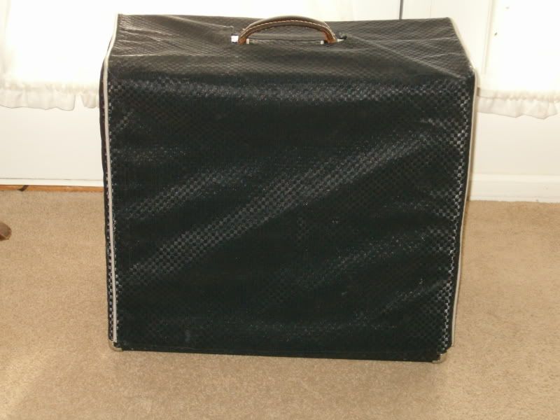

slider313 Posted December 16, 2009 Author Posted December 16, 2009 Nice!! Looks Brand New! Yeah Scott, it's in real good shape. The old matching grey cover is even real clean. He also gave me the original speaker, a Jensen C12R, which is in great condition. Those small magnet Jensens break up real quick and are good if your going to do some low volume recording.
