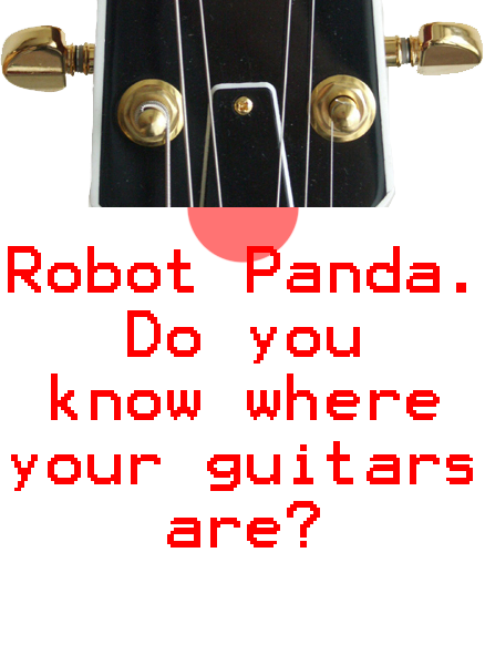

jhack Posted December 31, 2009 Posted December 31, 2009 Do you notice anything particular on this photo?
111518 Posted December 31, 2009 Posted December 31, 2009 The tuner on the right is, to quote a song, "close® to the edge."
slider313 Posted December 31, 2009 Posted December 31, 2009 The strings are wrapped the "wrong" way around the tuner post on the bass side.
smurph1 Posted December 31, 2009 Posted December 31, 2009 I don't like the way the headstock looks..LOL
FrankV Posted December 31, 2009 Posted December 31, 2009 for sure, the tuner on the right looks slightly higher and closer to the edge than it's brother on the left. is the guitar marked as a 2nd?
Dick Seacup Posted December 31, 2009 Posted December 31, 2009 If you take the truss rod cover to be the center of the neck, then the headstock appears (key word, there) to have more wood on the bass side than the treble side. As if the headstock was cut to the wrong profile. Look how much tuner shaft is showing on the treble side vice the bass side tuner shaft. The string spacing on the A-D-G-B look even. Could just be the tuner on the high-E is mislocated, though.
Jim W Posted December 31, 2009 Posted December 31, 2009 Yeah, it's a little out. The "charm" of handmade! Not a Heritage, but... Alicia has a 1964 Gretsch Country Club. The tuner holes were drilled by hand according to some Gretsch folks. The tuner button was rubbing the side of the headstock when turned, so I made a small tube spacer to push it out.

jhack Posted January 1, 2010 Author Posted January 1, 2010 Hi, I have to admit that since I realized this gap I do not see more than it. I want that we speak about "hand-made" but there all the same you should not exaggerate. For a guitar of this price it is inadmissible. I think that if I lived of the highly-rated of Miami I would have returned it, that also it is "charm" of the mail order buying..... I do not think that shall renew the experience.

iim7v7im7 Posted January 1, 2010 Posted January 1, 2010 My new H535 has the same flaw in the tuner post location just like yours. My 2000 Sweet 16 does not. The asymmetric location appears to be a feature of recent H535/H555 production. They may have done an entire run of necks with this production flaw. I understand your unhappiness and I to also regard this as a quality flaw. The drill and neck cutting operations can be done symetrically even without CNC as evidenced by my older Heritage. Make sure the guitar can intonate properly (mine did). Also, make sure your nut slots are properly cut to address the offset in the spread. Like mine, it is likely that your instrument will play fine and this will just be a aesthetic flaw. Good Luck, Bob Hi, I have to admit that since I realized this gap I do not see more than it. I want that we speak about "hand-made" but there all the same you should not exaggerate. For a guitar of this price it is inadmissible. I think that if I lived of the highly-rated of Miami I would have returned it, that also it is "charm" of the mail order buying..... I do not think that shall renew the experience.
PacerX Posted January 2, 2010 Posted January 2, 2010 My new H535 has the same flaw in the tuner post location just like yours. My 2000 Sweet 16 does not. The asymmetric location appears to be a feature of recent H535/H555 production. They may have done an entire run of necks with this production flaw. I understand your unhappiness and I to also regard this as a quality flaw. The drill and neck cutting operations can be done symetrically even without CNC as evidenced by my older Heritage. The drilling fixture has to be off, and you're spot-on with your evaluation: CNC isn't necessary there to get it right. Many of the CNC-based manufacturers use a drilling fixture with a drill press to put the holes in to save the money that would be required to buy a CNC machine that can drill the holes in automagically. You'd most likely need another axis (rotation of the cutter head) to get them in without a re-fixturing step. The 6-axis machines can do it without re-fixturing, but they are more expensive. The common myth is that folks get fired when CNC machines start taking over operations. Only a fool does that in a manufacturing operation like building guitars (where price point and the cost of materials and labor have a significant disconnect). A smart manufacturer takes those people and uses them for something else.

iim7v7im7 Posted January 2, 2010 Posted January 2, 2010 Hmmmm, I kind of like it. Makes it unique while being functionally irrevelant. While I understand your sentiment, it is not exactly unique feature when other instruments made at that time have the same "feature". My instrument was made last Oct-Nov and it has the same "unique feature". I suspect most 535/555 have that same feature made from a lot of necks. It is reflective of a level of quality that should not bear the name Heritage in my view. They are capable of making better. While it can be functionally irrelevant(your point), it has the potential to affect tuning. You have to be careful that the spread angle in your instrument's nut matches the positional offset of the tuning machine posts or you may have difficulty staying in tune due to friction. The tuner posts for E,A and D are inboard of their intended design position and G, B and A strings are correctly located. So you need to make sure that the spread angle in your nut is cut to match or unintended friction from side wall rubbing can ensue. My factory nut did not accomodate this, but my aftermarket one made by a luthier does. The guitar now stays in tune. When I first played it, after 1 or 2 songs with any bending it would go out of tune.
