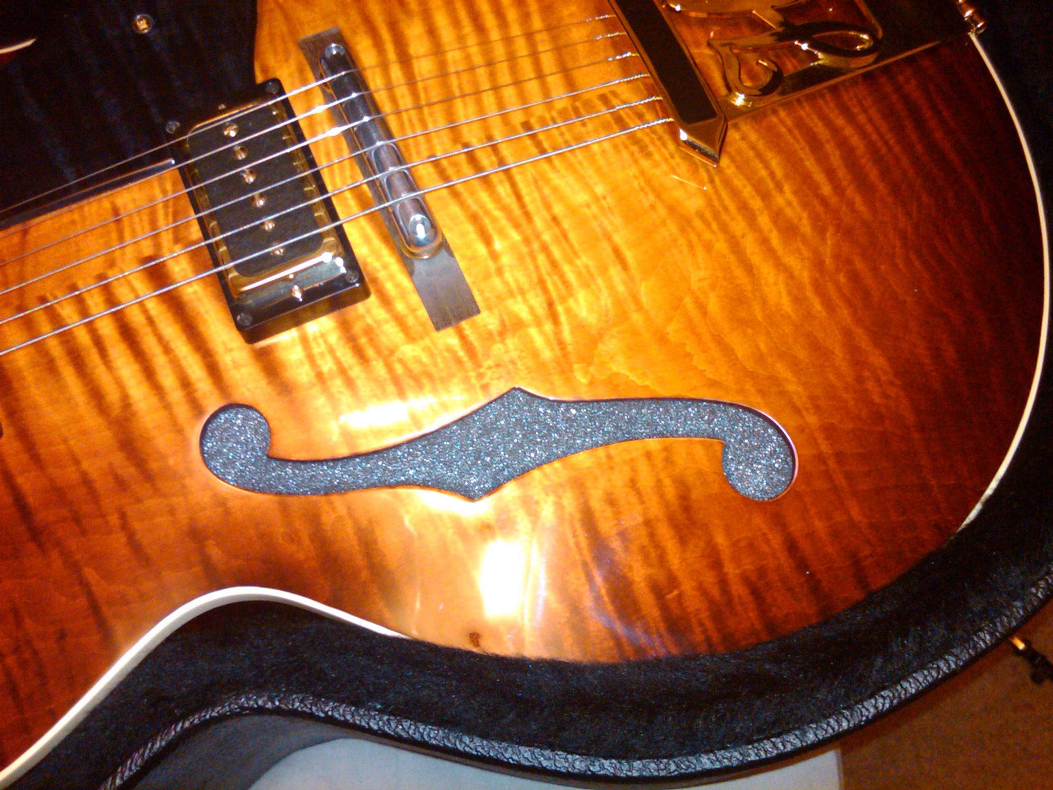

JohnCovach Posted January 24, 2010 Posted January 24, 2010 There was a thread recently about controlling feedback on 575's and other hollow-body electrics. Remedies mentioned were soundposts (not so good for solid top guitars) and foam. I remembered reading somewhere that Pat Metheny used to stuff a shirt in his 175 to reduce feedback, so I got the idea: why not use a scarf? The potential problem with most scarfs are the tassels at the end, so you'd need something that wouldn't have those, since they might catch on the internal wiring and/or screws. My wife suggested that you can buy fleece at the fabric store very inexpensively, so off we went. After buying way more than I could ever use for about $7, I came home and cut a piece about 51" long and 10" wide. I then fed it in the bass-side f hole of the 575; the fleece is black so you really can't even tell it's there from the front. Next it was over to the rehearsal studio, where I cranked the amp using significant gain. The result was that this did take the edge off the tendency to feed back: the guitar will still feed back if you take your hands off the strings, but it won't "take off" into a howl or scream. Still the same ol' howl when using the fuzztone, however, though it's ok as long as you're playing (so maybe a noise gate would fix that some). What I like about this makeshift scarf is that it's easily removed and reinstalled when needed, and can be conveniently stored in the case. And, of course, it otherwise comes in handy up here in the north during these cold winters! I'll try this solution out at the next show and report back.

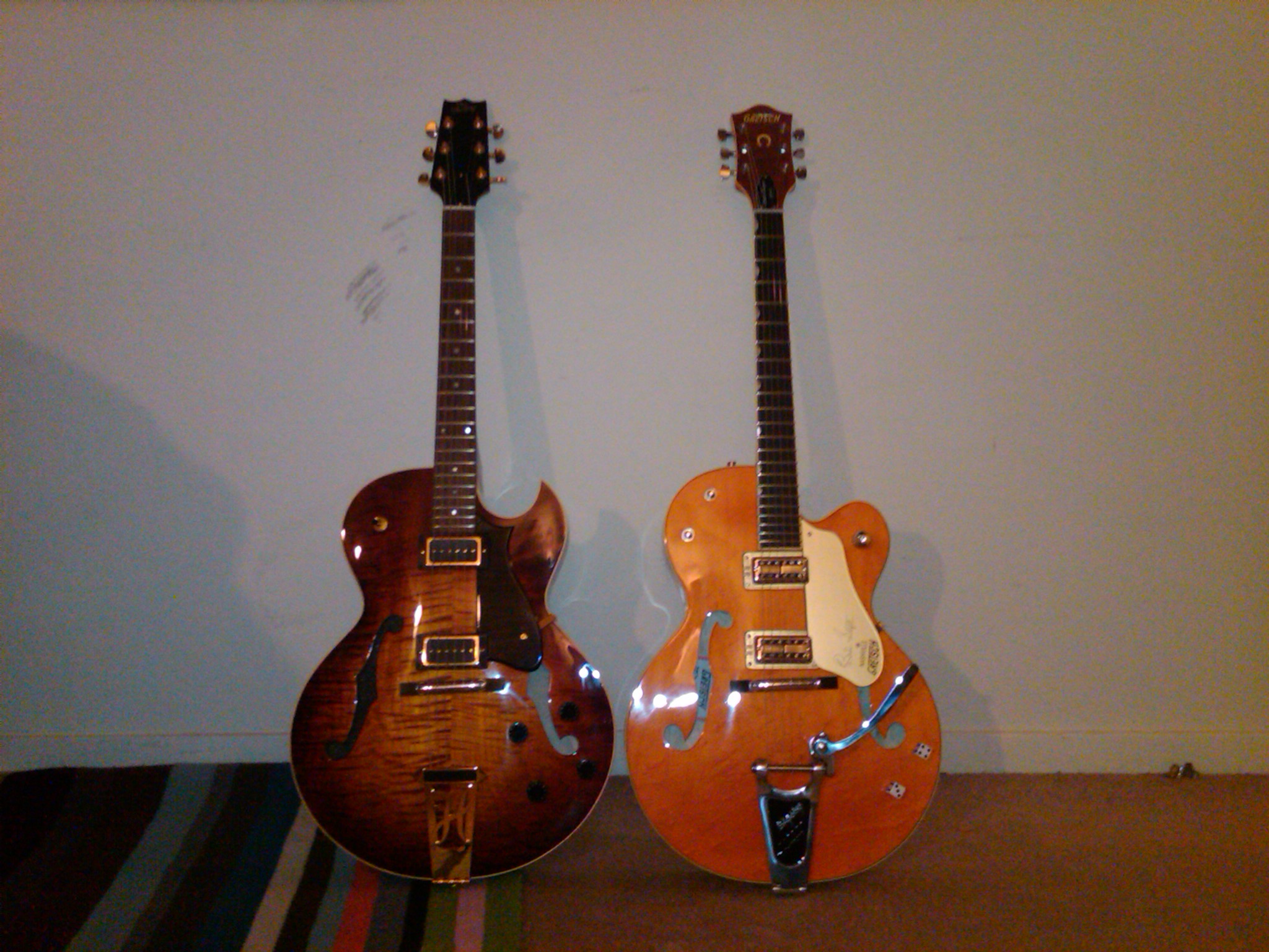

eor Posted February 5, 2010 Posted February 5, 2010 Yeah, they can hang.are those tru-arc brass bridges on those? if so (or not), what do you think? i have a stainless steel one on my gretsch. love it, saved me from having to replace the filtertrons. also, those p-90s (p-100s?) are pretty. what are they? i'd love a giant heritage to play along with the gretsch, but i probably won't be able to afford one for a while. and they'd have to be in different configs, to assuage my guilt. they cant just be different brands or colors. maybe a longer scale, or different pickups or something. as for feedback, try this: find out ahead of time where on stage (or home) you get controlled, uncontrollable and no feedback and park yourself accordingly. i use a buttload of gain at times but don't really have a problem with feedback, unless i'm looking for trouble. it also seems to me that some amps feedback more than others.

LH575 Posted February 6, 2010 Posted February 6, 2010 are those tru-arc brass bridges on those? if so (or not), what do you think? i have a stainless steel one on my gretsch. love it, saved me from having to replace the filtertrons. also, those p-90s (p-100s?) are pretty. what are they Both, in fact all my archtops, have the Tru-Arc Aluminum bridges. Best damn bridges on the market, in my humble opinion. The 575 has humbucker-shaped Lollar P90s. Rock and Roll.
