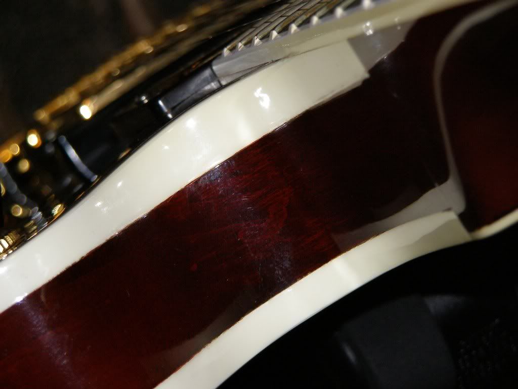

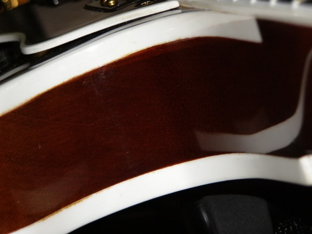

big bob Posted January 25, 2010 Posted January 25, 2010 My god, mine is the same way. Heritage really f-up on this one.. Just having fun with you Guido If it looks like this then every thing is good it is just the maple cap
Guido Posted January 25, 2010 Author Posted January 25, 2010 My god, mine is the same way. Heritage really f-up on this one.. Just having fun with you Guido If it looks like this then every thing is good it is just the maple cap Hi!!! YES it looks exactly the same!!! But this influences the neck. Like I said the neck is tilted due to the different body top heights.
SouthpawGuy Posted January 25, 2010 Posted January 25, 2010 Found this shot in the gallery, if you look closely you can see the cap. Is the neck straight when you look towards the bridge ?

Guido Posted January 25, 2010 Author Posted January 25, 2010 Found this shot in the gallery, if you look closely you can see the cap. Is the neck straight when you look towards the bridge ? That's exactly how my guitar looks!!! You can clearly see the bubble at the top in the cutaway. Are many guitars like this? What's the reason for it?

big bob Posted January 25, 2010 Posted January 25, 2010 all the 150's /157's/140's/147's are this way thats why they call them arch tops. Now lets see some pics of this new guitar!
SouthpawGuy Posted January 25, 2010 Posted January 25, 2010 That's exactly how my guitar looks!!!You can clearly see the bubble at the top in the cutaway. Are many guitars like this? What's the reason for it? I don't have a 150 but I have a 1990 G' Les Paul and I just took a look at it, the binding is thicker in that area unlike the Heritage where the binding is the same thickness and follows the curve of the arch top. Just different ways of doing the same job I guess.
tbonesullivan Posted January 25, 2010 Posted January 25, 2010 perfectly normal. The binding is the same thickness everywhere, but in the cutaway the maple cap is thicker than at the edges, so it doesn't cover completely, as other people have said. H150's have a "carved top" that is thicker towards the middle. When you have a cutaway it cuts into this. Some other makers have it more contoured around the cutaway to avoid this.
Guido Posted January 25, 2010 Author Posted January 25, 2010 perfectly normal. The binding is the same thickness everywhere, but in the cutaway the maple cap is thicker than at the edges, so it doesn't cover completely, as other people have said. H150's have a "carved top" that is thicker towards the middle. When you have a cutaway it cuts into this. Some other makers have it more contoured around the cutaway to avoid this. This explanation makes totally sense to me!!! Thanks
Thundersteel Posted January 25, 2010 Posted January 25, 2010 Like others have said, it's SUPPOSED to be that way! Some other manufacturers use binding to cover up that part; Heritage doesn't.

TalismanRich Posted January 25, 2010 Posted January 25, 2010 Guido, there's no shame in questioning something that looks amiss. Sometimes it's a mistake, sometimes it's made that way. FYI, here are my 157 (you can see the maple cap) and my Mille LE. The Mille has the wider binding like was mentioned about a Les Paul. This is the 157 The bit of stain around the binding is due to having the guitar refinished after it took a bath in a flooded basement. This is the Mille Welcome to the HOC and enjoy that 150!!!!
