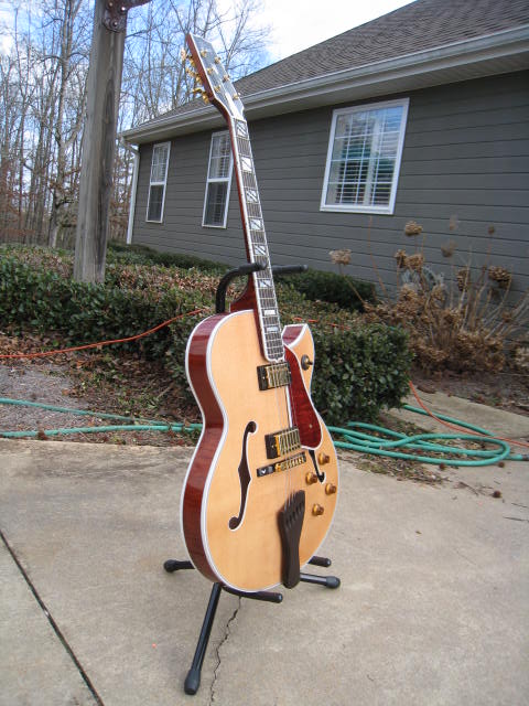

LH575 Posted March 1, 2010 Posted March 1, 2010 I just ordered some parts to add the Bigsby B6. I am having a custom mounting plate made do I don't have to drill nay extra holes in the guitar. Swapping all the gold hardware for chrome/aluminum in the process. Adding some locking Grovers too. In the meantime, does anyone have any photos of H575's with a Bigsby? Would love to see them! Rock on. 575

LH575 Posted April 14, 2010 Author Posted April 14, 2010 I should add.... don't do it if you leave screw holes showing. The mod has to be clean. The 550 at Elderly's is disfigured. Cool thing about the B6 - no other holes besides the mounting plate. Totally reversible. Still waiting for the custom Bigsby, hopefully a month or so. Shmockiebaby, that's a beauty!

Shmockiebaby Posted April 17, 2010 Posted April 17, 2010 Here's a coupla pics. You can see how I used a couple of straplock pieces to fit the output jack to the Bigsby. When I got it, it was just loose in there, barely holding on. I used the curved, cupped washer on the backside of the tailpiece (you can;t see it), and it fit right into the hole in the boy, served to help center everything. Then I used the flat washer on the outside, where you can even read the strap lock engraving. It's not permanent, but it is solid, secure, and totally playable. It could be permanent if desired, it's just not very elegant. I think the best solution would be to make a piece of aluminum the same shape as the tail piece, including the three mounting holes, and then drill a hole in the center for the output jack. Attach the jack, and then sandwich the whole rig and assemble. I dunno, we'll see. Also note the bridge. Seems like too many pieces, must be a tone sucker. I will look for a better solution. Maybe a Bigsby bridge, but they are intonated for a wound G, and I play a plain G. I don't like ABR-1, the little hairspring always buzzes. Roller bridges are tone suckers. I may try a rosewood/bone bridge and see how that works - not normal for Bigsby, but I only give it a gentle wiggle when I use it anyway. Having trouble uploading pictures......I'll keep trying.

LH575 Posted April 17, 2010 Author Posted April 17, 2010 I think the best solution would be to make a piece of aluminum the same shape as the tail piece, including the three mounting holes, and then drill a hole in the center for the output jack. Attach the jack, and then sandwich the whole rig and assemble. I dunno, we'll see. That is exactly what I am having done. I'll post photos when I get it. Not cheap, but worth the price to not drill extra holes.
