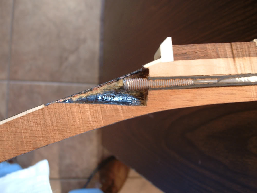

fxdx99 Posted April 26, 2010 Posted April 26, 2010 By design, any guitar with an angled headstock that breaks the parallel plane formed from the back of the body is exposed to breaking more than a guitar with a parallel-to-neck headstock (example LP vs Tele style). Lay your guitar on a table - if the back of the headstock hits the table and there's space underneath the body, the design inherently is more exposed on a fall where the headstock is the first point to hit. That said, Heritage knows how to build guitars and compensate as much as possible. Whoa - Mark's experience sounds like a testament to build integrity. Ouch.

pro-fusion Posted April 26, 2010 Posted April 26, 2010 It seems like you hear these headstock stories more about SGs than about any other Gibson, and I'm not sure why. Early SGs also have a problem with the neck joint coming undone because there isn't a large point of contact between the neck and body. Gibson's idea of using a volute was a great way to reinforce the headstock, and I'm not sure why all of the vintage snobs got all pissy about it. It represents a real improvement in the design.
smurph1 Posted April 26, 2010 Posted April 26, 2010 It seems like you hear these headstock stories more about SGs than about any other Gibson, and I'm not sure why. Early SGs also have a problem with the neck joint coming undone because there isn't a large point of contact between the neck and body. Gibson's idea of using a volute was a great way to reinforce the headstock, and I'm not sure why all of the vintage snobs got all pissy about it. It represents a real improvement in the design.[/qu
FredZepp Posted April 26, 2010 Posted April 26, 2010 It seems like you hear these headstock stories more about SGs than about any other Gibson, and I'm not sure why. Early SGs also have a problem with the neck joint coming undone because there isn't a large point of contact between the neck and body. Gibson's idea of using a volute was a great way to reinforce the headstock, and I'm not sure why all of the vintage snobs got all pissy about it. It represents a real improvement in the design. Probably Townshends fault ( about the SG's ) , don't you think...? I think that that cutaway pic explains it pretty well, I became more cautious after seeing it.. and yeah the volute was right under the thinnest part , I believe. But Gibby was making so many bad decisions at the time, they couldn't be trusted to get one right.
smurph1 Posted April 26, 2010 Posted April 26, 2010 Probably Townshends fault ( about the SG's ) , don't you think...? I think that that cutaway pic explains it pretty well, I became more cautious after seeing it.. and yeah the volute was right under the thinnest part , I believe. But Gibby was making so many bad decisions at the time, they couldn't be trusted to get one right. Yeppers!!
