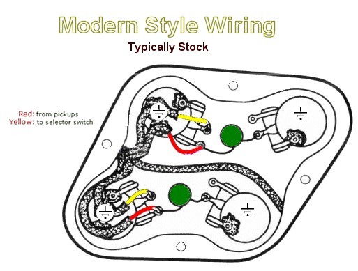

daiku Posted April 28, 2010 Posted April 28, 2010 Well, here we go with my first dumb question in the forum, and probably not my last I got my Heritage today, and am very excited. This is the first Gibson style guitar for me and the Toggle switch has me somewhat suprised. I get the Bridge Only and Neck only positions, but can you explain the center position? What is the rational behind the wiring of the volume pots and the center position? Is it to insure that both pickups are active in the center position? I notice if I turn down one of the pickups completely, I get no sound, even if the other is maxed. Wouldn't I still be getting sound from the pickup that is on? Just trying to figure it out. I'll post pictures soon, once the weather improves and I can get a nice outdoor shot like the nice ones I see here Clueless on the west coast, jim
Steiner Posted April 28, 2010 Posted April 28, 2010 Howdy clueless left side - the center position has both pickups on. Try blending the jazzy neck position with the treblely bridge position 'till you find "your sound". When one volume is off it cuts the circuit so no signal passes through, no big deal, the center position is for mixing the two. Should you desire one or the other, just flip the switch! Enjoy!!!

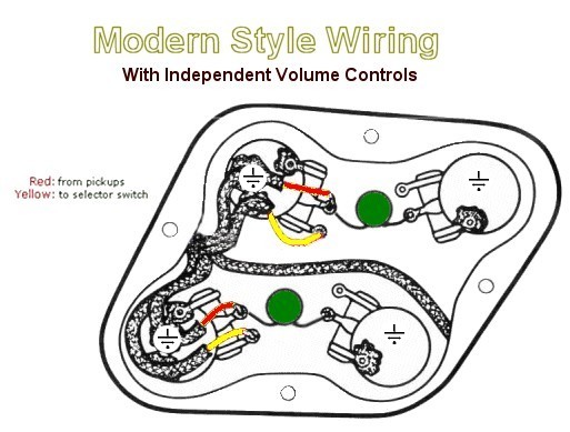

MuDBoNe Posted April 28, 2010 Posted April 28, 2010 Hi, for me, the middle position is the real secret for getting great tone. You can add or remove the pickup blending to create a wide variety of sounds. When I got my Heritage H150CM, someone had wired the pickups to be on (in the middle postion) if the other pickup was turned down. The guitar sounded like the treble had been completely removed as soon as you turned down either volume. The way yours is now is very versitile. Here are 2 pictures from another site I had saved when I fixed mine.

H Posted April 29, 2010 Posted April 29, 2010 Hi, have a read of this: http://www.mylespaul.com/forums/tonefreaks...s-les-paul.html Gbrand LPs and four pot Heritages seem to be wired the same way so the hints and tips and that link should work. They do for my H-535 regards, H

FredZepp Posted April 29, 2010 Posted April 29, 2010 Magnet flip refers to the out-of-phase sound that P Greens LP had. The polarity of the magnet was reversed so when both pickups were used it was out of phase. You can do an out of phase sound with the wiring also. As to the center position... I use it quite a bit . And when I'm setting up my pickup adjustments, I look not only to how they sound separately , but also how they sound together in this position. (That center position sound is important for those Zeppelin tones.. )
