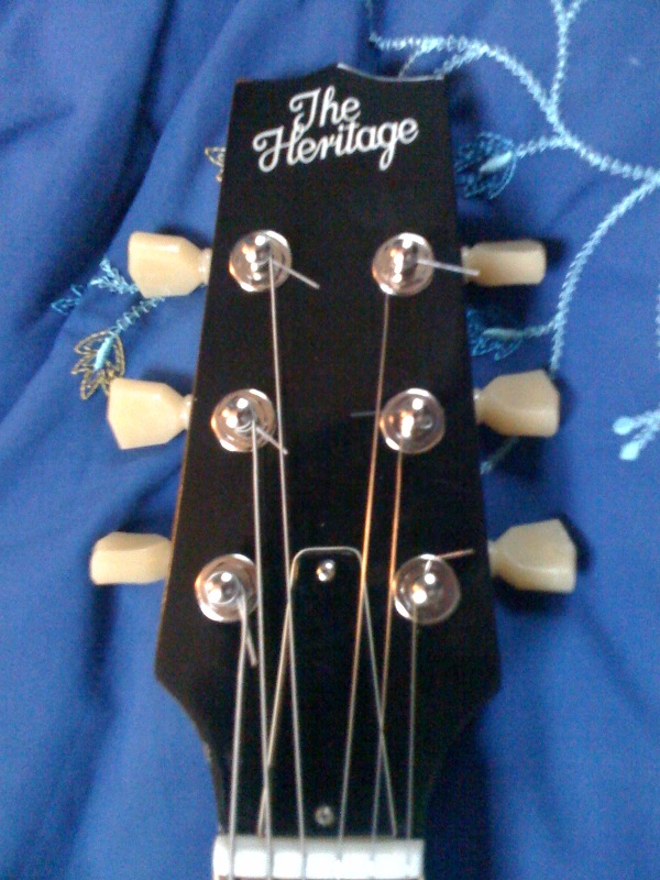

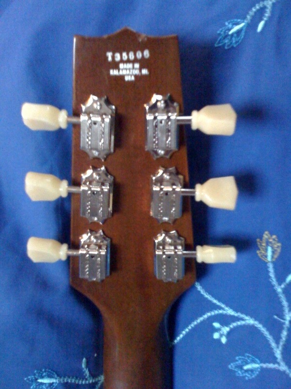

H Posted May 4, 2010 Posted May 4, 2010 Swapped out my H-535's Grover Rotomatics for TonePros Klusons Easy change-out and looks great IMHO Got sick of the Grovers tarnishing every week and these look like a natural replacement. They're cream like the binding and well worth the $35 I paid for them and the shipping to the UK

fxdx99 Posted May 4, 2010 Posted May 4, 2010 Swapped out my H-535's Grover Rotomatics for TonePros Klusons Easy change-out and looks great IMHO Got sick of the Grovers tarnishing every week and these look like a natural replacement. They're cream like the binding and well worth the $35 I paid for them and the shipping to the UK Nice - I've Sperzels on 2 Heritages, Grovers on the other 2. Just the way they were ordered, I guess. Were the Klusons a direct replacement, same size and location screws?
H Posted May 5, 2010 Author Posted May 5, 2010 Nice - I've Sperzels on 2 Heritages, Grovers on the other 2. Just the way they were ordered, I guess. Were the Klusons a direct replacement, same size and location screws? Yep, they go straight in with just one extra hole to drill per tuner. Klusons are held by two screws, Rotomatics by one but the Grover screw hole is in the right place for the Kluson. Perfect
