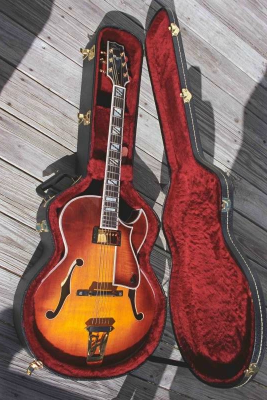

Gitfiddler Posted May 30, 2010 Posted May 30, 2010 I've have some Thomastik-Infeld 13-53 Jazz Swing flat wounds that I'd like to try out on my Sweet 16. My only reservation is this. Will the increased tension of these heavier gauge strings be too much for this 25.5 scale archtop? I recall Ren recommending nothing greater than 12's. Why? Will the 13's cause more downward pressure on the top? Will the transition to a higher gauge necessitate a set up? Finally, I don't want to screw up or potentially damage this wonderful guitar. I'm pretty sure there will be a change in tone from the previous strings that I've used on this fine guitar (D'Addario Chrome flats, and Half Round 12's). Acoustically the guitar rings better with the Half Rounds of course, but has more of a the traditional jazz thump with the flats. Since I play mostly plugged in, I've decided on flats going forward. Recently I've read about players using 12 or 13 Roundwounds on their archtops. That is another option, but I'll wait to hear from other players about the 13's first. Tim

Gitfiddler Posted May 31, 2010 Author Posted May 31, 2010 Thanks for the thoughts, ideas, examples and especially the photo from the hardware store. John Scofield uses 13's on his old Ibanez AS200 semi-hollow, and his signature model JSM100 semi comes from the factory with 13's in his honor. Yikes!! He must have fingers stronger than Victor Wooten the way he plays his jazz runs. As for the Sweet 16, I do not want to take a chance on sinking the top or stressing the neck. She came to me used and I have no idea if it is tap tuned. (Does Heritage write that on the label of tap tuned archtops?) Also, the neck re-set comment gave me the Willies! Anyway, I think I'll save the TI 13's for the H550 (Babs) . As a laminate top with minimal arch, I feel safer experimenting on that big blonde rather than on Sweetie.

jrfreed Posted June 2, 2010 Posted June 2, 2010 I strung my Eastman archtop with 13's and wont go back...that extra mass really gets the solid top working. They added more pop and depth to the overall sound that I would have a hard time giving back. The ideal sound for me is 75% amplified sound with 25% accoustic sound for jazz. To answer your direct questions...yes on a new setup...yes on more downward pressure on the top, but you get rewarded for that with a bigger/fuller sound. I cant believe Heritage would make an archtop...specificially targeted at jazz players...unable to handle the stress of 13 guage strings. Just my 0.02

Windstring Posted June 2, 2010 Posted June 2, 2010 Other folks have alluded to this already, but I cannot see any reason to avoid the 13s on your guitar. These Heritage archtops can take it, no problem. The only thing you might have to do is tighten the truss rod to keep the action flat. I use 13s on a Sweet 16 because I like to have a loud acoustic sound, plus I actually like the "workout" my fingers get....other guitars strung with lighter strings are SO easy to play afterward! Please note that if you get the truss rod right, and the action very low, the guitar remains very playable despite the heavier strings. But, here's my disclaimer: if you are not familiar/proficient with truss rod adjustments, leave the set up to a professional. Just adding my 3 cents worth... Cheers.
