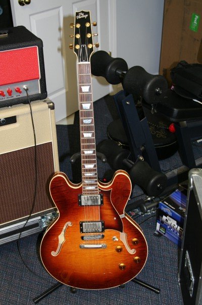

skydog958 Posted July 2, 2010 Posted July 2, 2010 Howdy fellas! I've had my H-535 for a few years now, but just joined the forum a couple days ago. Now, I've always loved how the guitar has played, but she often had issues with feedback. Lo and behold, I finally check to see what the pickup make is, and they are Seth Lovers and not '59s as I previously thought (I knew they were SD's). So given this opportunity, I'm looking for boutique, high-gain friendly PAFs. Right now I'm bouncing between Lollar Imperials, WCRs, or perhaps Bare Knuckles. Any thoughts?
Patrick Posted July 2, 2010 Posted July 2, 2010 Attached is a pic of the old gal: That's a nice guitar. I like the trap' inlays, the bound head stock and the inlayed logo. Did you order it new?

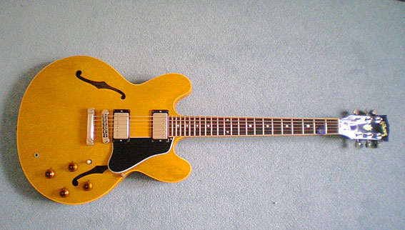

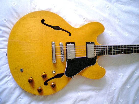

peteraltongreen Posted July 2, 2010 Posted July 2, 2010 Hi 'skydog958' Firstly,if the 958 in your site name refers to Sept,1958,I'd been playing guitar exactly 1 year ! Now,serious matters. Your 535 looks great.I have a Gibson ES335 from 1982,which I bought in San Francisco.I'm not sure if it was the last of the 335's made in Kalamazoo,or whether it was made in Nashville.Both sites are mentioned on the label.I'm not sure what the pickups are,but at higher volume,I do get an interaction between the guitar & the amp.It's not feedback,but sustain.It performs great at this level,as the notes just sing ! I had Seymour '59's fitted to my Heritage CM140 (1986 ),and these were a definite improvement on the Schallers.I've also got a Guild Bluesbird with these on,and as it's chambered,it's like a single cut,smaller body 335.This also sounds great at any volume.As an older player,I tend not to add too much distortion or high gain to my sound.It usually happens naturally in my set up.Hope this doesn't confuse the issue . Peter Alton Green
skydog958 Posted July 2, 2010 Author Posted July 2, 2010 Patrick: I got it off of eBay, of all places. There's also binding inside the f-holes, which I really like. Peter: heh the numbers are a funny story...they were chosen randomly, but incidentally they are the three different digits in my birthday (in order, too!). Just add one more 8 and a couple of backslashes... Anyway, I should have been more specific. I like musical feedback, but the kind mentioned below is microphonic feedback due to the pickups not being wax potted. My main amp is a Dr. Z SRZ-65 (think a really good JCM 800), and I like to crank her up pretty loudly. The neck pickup is particularly problematic--I can't even have the guitar volume up all the way without full-on howl. Btw, really like the simple, elegant look of your 335. I'm pretty sure it was made in Kalamazoo--I don't think Gibson shut down there until '84. And you happen to share a name with one of my favorite guitarists! You're not from Britain, are ya? lol
