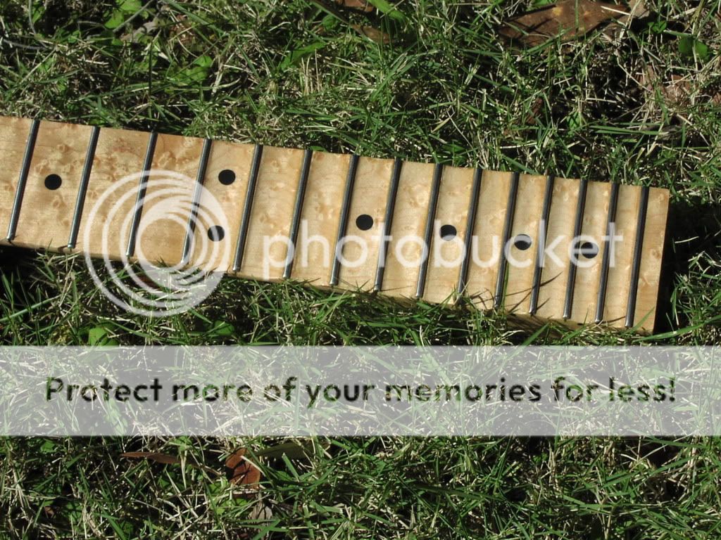

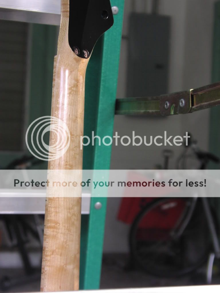

cod65 Posted July 12, 2010 Posted July 12, 2010 I love me some tru -oiled necks. I did this to my 79 carvin from head to toe and nvere regretted it . scraped off every inch of the thick poly (except on the fretboard) and rubbed 30-50 coats of tru-oil . love it. smooth and solid.

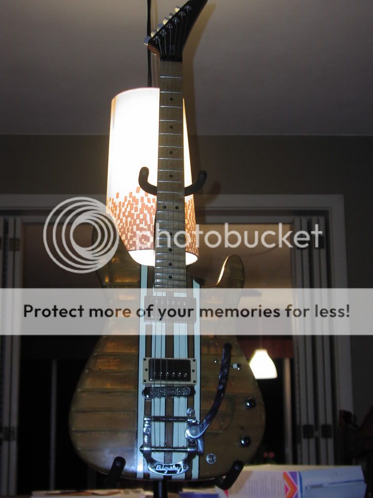

big bob Posted July 12, 2010 Posted July 12, 2010 so I just got done playing quite a bit, played the stat dlx (nitro neck) and my home build (tru-oil) ... and the verdict.. the Hog neck on the stat is much fatter and better for chords, like the 12" radius, OH and she sounds sweet and FAT.. The surf caster home build is far easier in the money frets, the scalping helps and the extra access also. but I do believe that after quite a bit o playing here in florida in the HOT the tru oil neck stays "dryer" ie not as sticky... Would I sand down my stat dlx and tru oil the neck... NO but if your 575 is a keeper/player why not.. you can always remove the tru-oil with mineral spirits and re-clear.. Stat dlx surf caster
