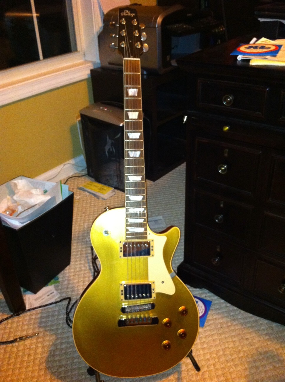

Bonefish Posted July 10, 2010 Posted July 10, 2010 First, thanks so much for this forum (although my wife doesn't appreciate that you kept me up until 2:00 in the morning). I have a 1996 H-150 Gold Top guitar (mine since 1997). We were separated for about 6 years, but are fast renewing our friendship. It's such an awesome guitar I only wish I could show it more sonic respect than my Line6 Flextone Duo can provide. Maybe one day ... My question is if anyone knows what type of pickups are in this guitar and if after 6 years of rest I should be mindful of making any adjustments. I'm trying to be much more sonically aware this time around with my playing and so if anyone has any pointers on the setup of the pickups that would be greatly appreciated. Also, at the moment I have D'Addario 11 Nickel Wounds on there. Any recommendations on getting a fuller sound (at same gauge). Most of my playing is at church so the style tends to fall in the Coldplay, U2, Nationals, genre. (sorry about the lousy lighting on the picture, its 2 am!)
fxdx99 Posted July 10, 2010 Posted July 10, 2010 Nice Goldie there. The 2 per side adjust screws would indicate you have 'stock' pickups for that year, Schallers. "Measuring between the top of the pickups and the bottom of the strings, with the strings depressed at the last fret, the best advice is to start with a gap of 1/16 inch between bridge pickup and strings and 3/32 inch between neck pickup and strings..." I usually like mine a tab lower than the above starting point, but use your ears to the the judge. For string to string, listen to ensure it's balanced across the guitar and between neck/bridge pickups. There's tons of pickups out there to experiment with, although Schallers are fine classic sounding pickups and no need to swap 'em out. Should the 'I can't leave it alone and have to mess with it' bug get you (I can relate) Tom Short's get good press on this forum as do Throbaks. Seth Lovers by SD are a personal fav of mine for the money.
FredZepp Posted July 10, 2010 Posted July 10, 2010 If you are up until 2 AM checking out the Heritage Owners Club forum, you must really appreciate the beauty of these guitars... you'll fit right in. Welcome. There is nothing wrong at all with the Schallers that your 150 has (btw, great looking guitar ) , it depends on if you'd like to change the sound. You'd probably open it up some ( more transparent ) with Seth Lovers , Tom Shorts, Sheptones, or Antiquities. A SD '59 would likely provide more mid range bark. Then of course there are hot pickups, but that probably doesn't fit your music too well.
Bonefish Posted July 10, 2010 Author Posted July 10, 2010 Thanks for the quick feedback! One thing I liked about the guitar when I bought it was that the pups gave it a slightly less edgy les paul feel. I've had countless people comment on how much they like the look and feel of the guitar over the years. I'll probably leave pups as is for now, but may think about changing them out after I update my amp (wanting a purer tone from my amp, the flexibility of the Flextone was fun, but I'm in a bit of a different place now). I'm going to replace strings, clean frets and fretboard and adjust intonation tonight. I'll also check out the spacing between the strings and the pups while I'm at it. Glad I found this forum, it's AWESOME!

brentrocks Posted July 10, 2010 Posted July 10, 2010 Nice GT!!! looks like Schallers to me....do you like the tone....i think they are pretty good pups!!

barrymclark Posted July 12, 2010 Posted July 12, 2010 First, thanks so much for this forum (although my wife doesn't appreciate that you kept me up until 2:00 in the morning). I have a 1996 H-150 Gold Top guitar (mine since 1997). We were separated for about 6 years, but are fast renewing our friendship. It's such an awesome guitar I only wish I could show it more sonic respect than my Line6 Flextone Duo can provide. Maybe one day ... My question is if anyone knows what type of pickups are in this guitar and if after 6 years of rest I should be mindful of making any adjustments. I'm trying to be much more sonically aware this time around with my playing and so if anyone has any pointers on the setup of the pickups that would be greatly appreciated. Also, at the moment I have D'Addario 11 Nickel Wounds on there. Any recommendations on getting a fuller sound (at same gauge). Most of my playing is at church so the style tends to fall in the Coldplay, U2, Nationals, genre. (sorry about the lousy lighting on the picture, its 2 am!) Beauty of a GT! First, I back up Brent in that these appear to be Schallers. I absolutely love these type of pickups but, then, I also like the old PAF type which the Schaller Golden 50's are modeled after. Strings wise, D'Addario makes a fine string. I use them almost exclusively just because of how easy they are to get but they also sound good. Lastly, there is nothing wrong with a Line6 anything. If you like the sound, then cool. Issue resolved. If you just have it because you have it and really aren't sold on the sound and hope to get another, that is another story. I played Line6 amps and PODs for years. They do fine. I'd have no problem using one if that is what I had.
